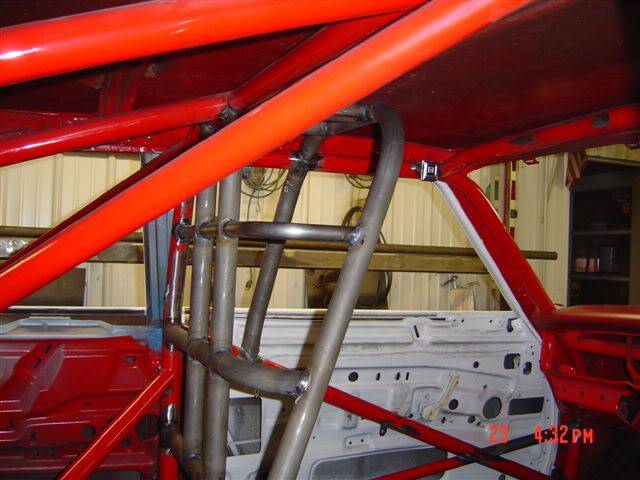

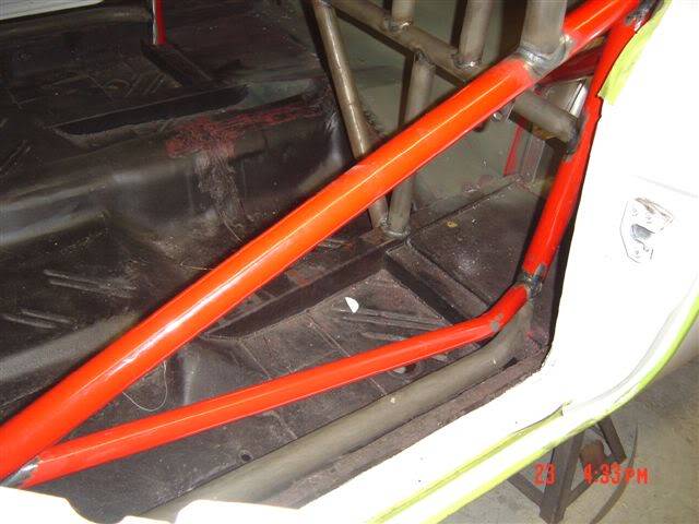

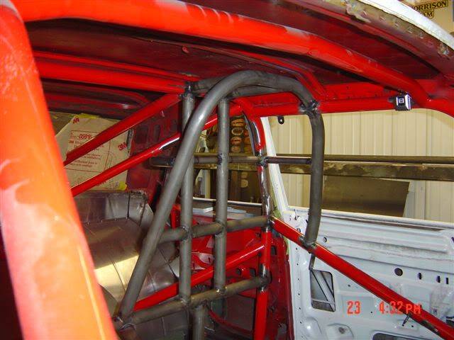

Funny Car Cage Complete....

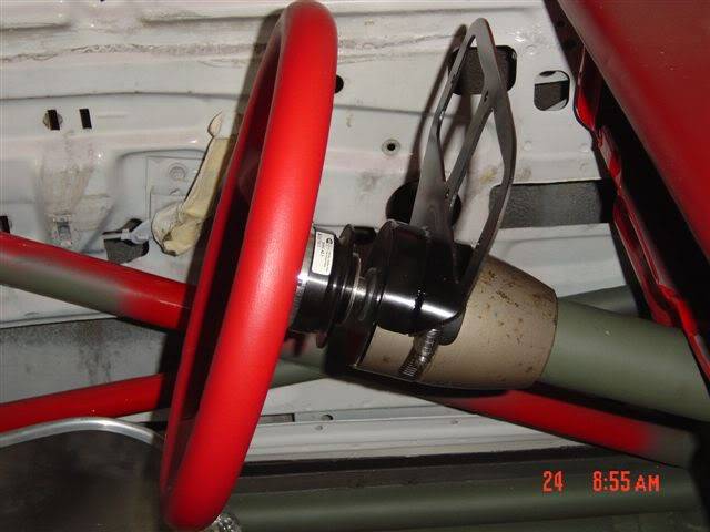

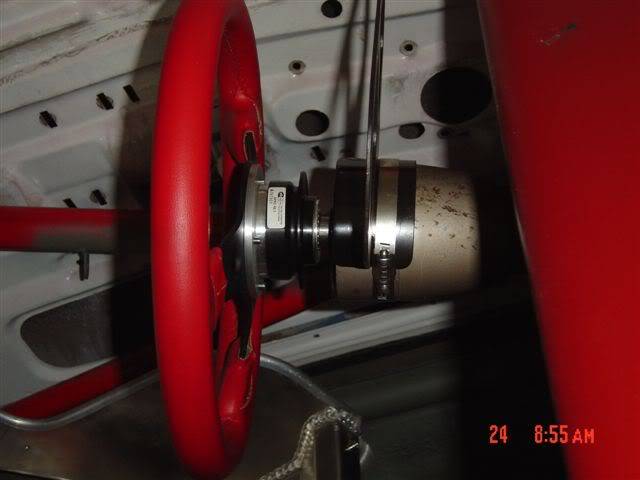

Racepak Dask Column Bracket...
Looking good.. Are you going to have another bar in line going down from the bottom of the front upper hoop of the FC cage down to the main hoop, from under the side bar, to have the bar be complete ? .... Just curious

Glad to see the upgrade and that the exsisting bars were used.This will be stout!!:headbang:
Im not understand which bar you are saying?
Yeah I know Al but to be honest im a little upset that any of the bars had to come out... You live and learn... Expensive lesson I guess.... But no doubt its going to be a fun ride.... Ill tell you after seeing that paint job on that Duster on Sunday im thinking about changing the paint job....
From the side bar down to the main hoop, directly under the front hoop of the F/C cage...
