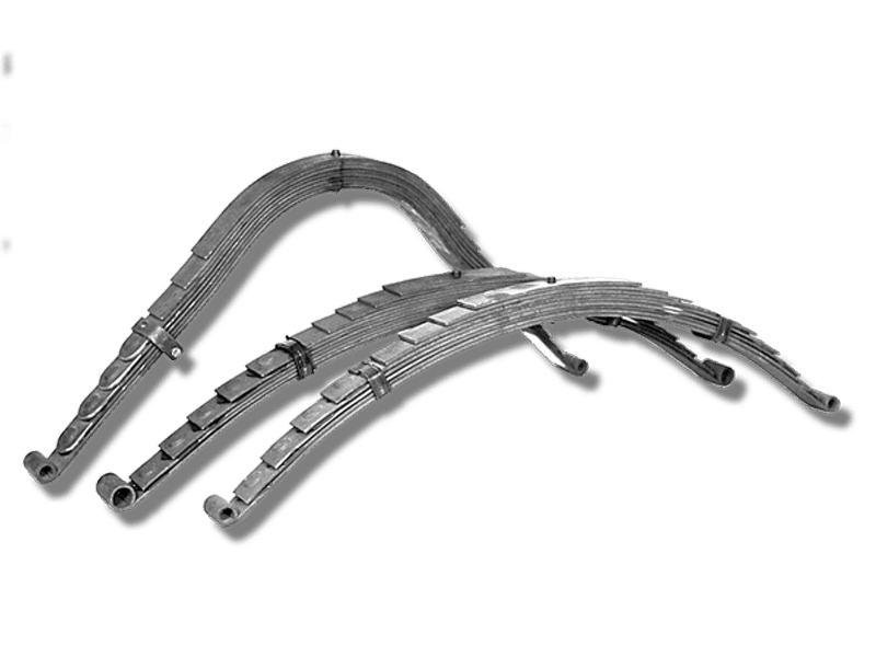

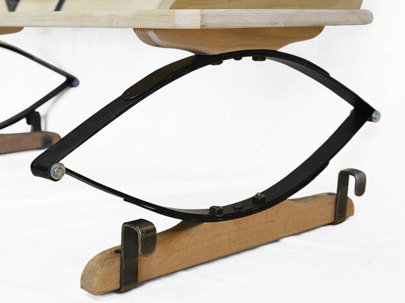

A buggy spring is an eliptical design or a semi eliptical design.
Early Fords used semi eliptical springs on both front and rear axles.
