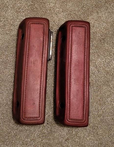

I recently bought 2 original rear pads for spares.
And after doing some research.....it had me worried they were wrong for my car.

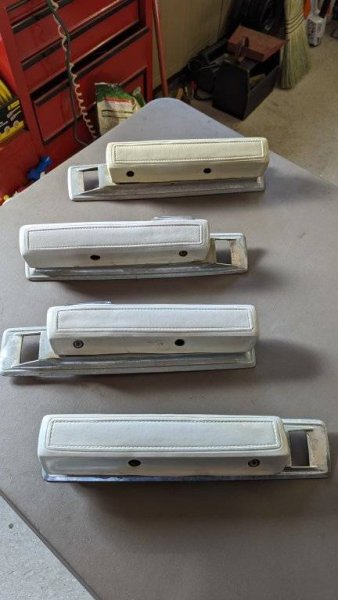

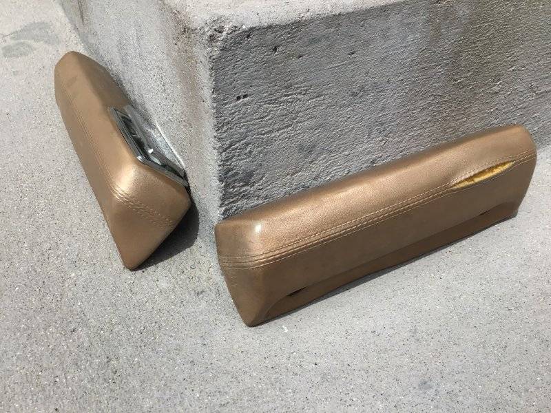

Here are the other arm rests
Coronet 440/ Belvedere II and lower level interiors.
they all take the same style of base 1966-1970. Some are same color as interior and not chrome.
