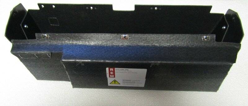

I recently bought a glovebox liner for my car.
How the heck do you put these in.
it looks like the liner is folded all wrong for the car where it attaches to the dash frame
I put mine in from behind and it wasn’t easy. A lot of finagling to get it in but it does go it. I started with one screw hole in position, then another then another. If it’s the correct part it will go in. Patience in the key… and a LOT of finagling.
I folded mine up at the ends and went in from the front at an angle then unfolded it and put in the screws. Still wasn't easy.
Looks like it's a pita. Good luck. Send me a plane ticket and I'll come install it for you
Well.
I got it in over the weekend.
That was no fun .
Basically took it apart and in from the front.
Once inside the dash reassemble the liner and attach to dash frame .
But...its in there
