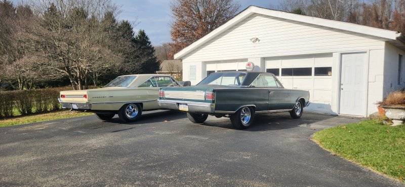

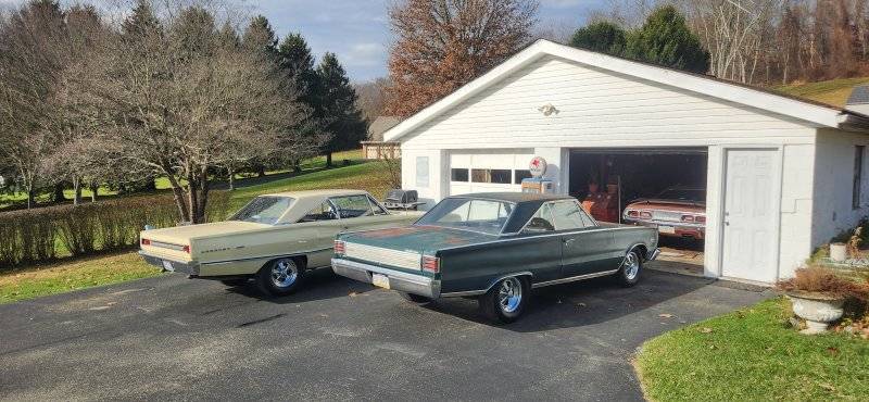

The coronet has a 255/70 and the plymouth has a 275/60. Either fit either car. Both 15x7 with 4.25 bs. I did trim the outer wheel lip some with a wheel.

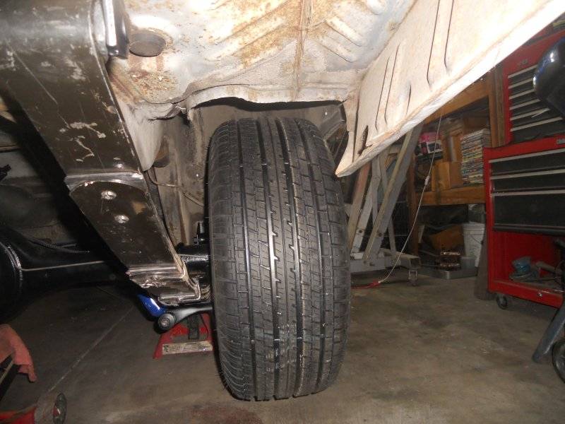

I tossed the back end up today and did some measuring of existing dimensions with the 225/70-14 on 14x5.5". 3" bs with the tire bulging 1.5" past the wheel lip each side. Currently there is 2" on either side of that with the existing to the wheel lip and the spring. The 15x7 cop unit has 4"bs with 3" on the outer. So if my calculations are correct, without beer, I would have 1" to the spring for clearance and around that to the lip if I run 275/60 in the rear. If I do 255/70 I'll gain a little on both plus be almost 3/4" taller. Front looks like I have enough room to use a 245/60 or a 225/70. 235/60 is pretty much a plus one in sizing up from the 225/70-14. Not much difference. I have a cut off piece of fiberglass sledge hammer handle that I've used in the past to put between the tire and lip to move the lip around by rolling the car back and forth, not forcing it all at once but a little at a time. Will check again in the future before I get new tires. Plus I'd like to get the wheels blasted and powdered, most likely tan to match the car and use the existing caps that are on it.
