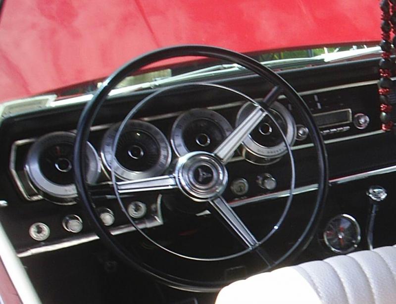

1966 Bright Red 361 Survivor

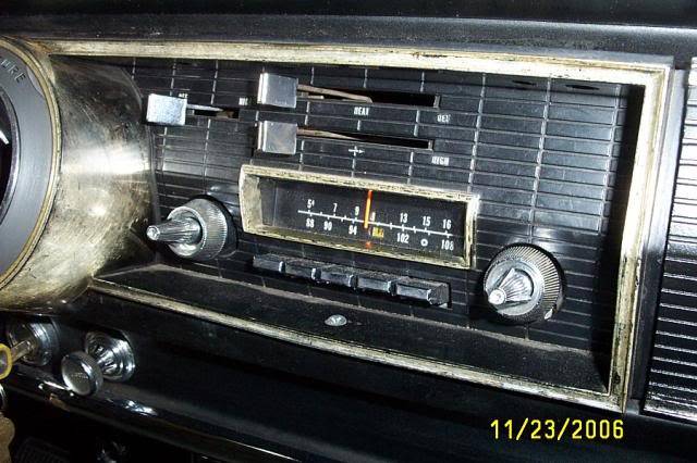

Yep, forgot about this part of our convo last week. My selector buttons are black....

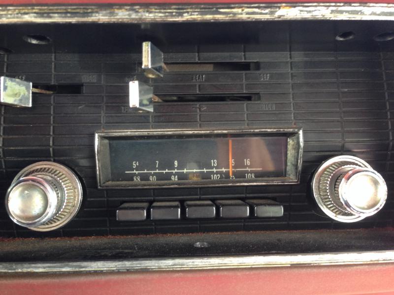

I put this in, but here is a factory AM/FM Charger radio.
Sorry for the crappy pic, I looked through my stuff and don't have a good shot of the dash. In any case, other than 2 rows of frequency, it looks exactly like the regular radio.
due to the black push-buttons....I'm betting it's originally from a 70 & up "A" body....Dart, Duster, etc. I got a couple here that don't work. And yer knobs are 67 style, not 66...just for info
The face is the same as my 66-67 "B" body radio
