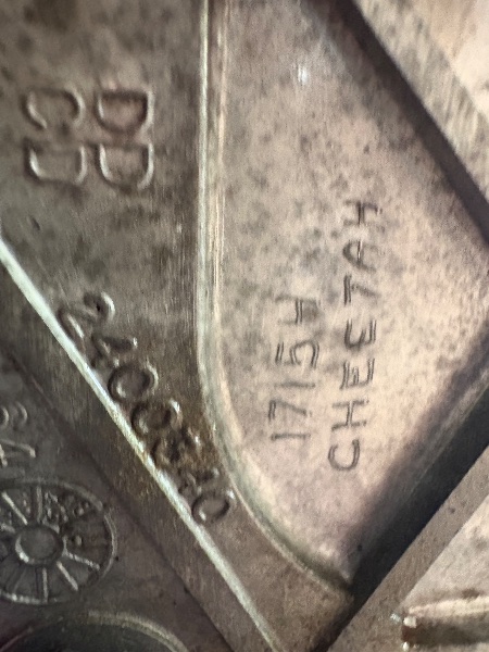

I purchased a transmission from a guy with a 67 charger because he went with a new hemi and transmission. I checked the numbers on the side of the train by the pan and it is a 67 727 big block transmission. I took the trans pan off and noticed valve body said cheetah 17154. I bought a deeper pan and filter extension and was tearing it down today to start the rebuild process and noticed the valve body and trans filter has two holes in it a filter extension for a 67 only comes with one hole in it. I did some research and one hole is for the rear pump I believe but seeing how this is not a push button trans can I still just use the one hole filter extension? Any help is very much appreciated. Thank you in advance.

Is that number etched into the separator plate or into one of the covers that screws onto the side of the valve body?

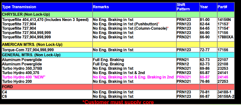

The list says it's for a 64/65. So that would be a cable shift valve body and your 68 trans os not cable shift. Sounds like someone has been swapping parts around.
I contacted Turbo action and spoke to the owner and he surprised that I even have it. He said he only made about 10 of those back then. It is for a push button trans. The guy I bought it off of said the trans worked and shifted fine and the only reason why he was getting rid of it is because he went with a new gen hemi swap. He is not a car guy. He has other people do the work on his vehicle. But like I said, he said it drove fine. He just always had to manually shift it. I’m just wondering if that second hole can be blocked off with the single hole filter extension.

Someone has played Mix N Match with the valve body parts. That little spoked wheel on the lower left tells what month of the year the plate was cast. Beside it is the year; 64. It is hard to say what internal modifications have been made to the valve body, but the '67 transmission definitely does not have a rear pump. I would just use your single hole extension and filter, and hope for the best.
