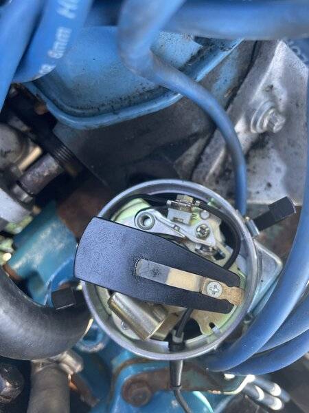

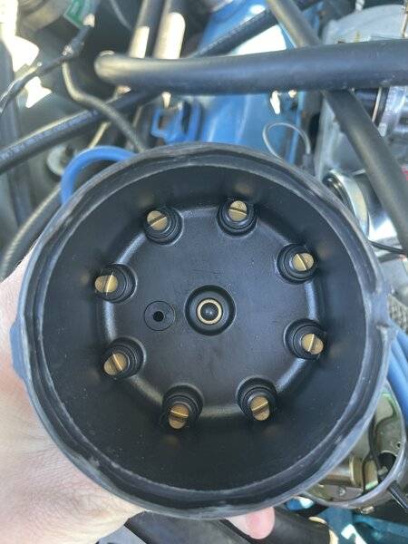

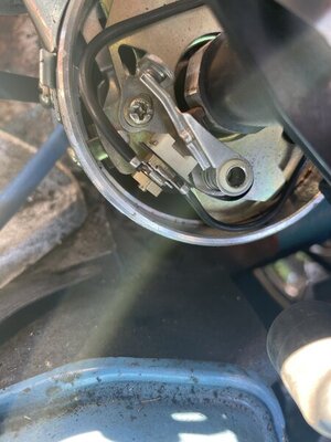

Open the distributor cap. Take a pic of the points. Let’s see if maybe their burnt.
I can do that.

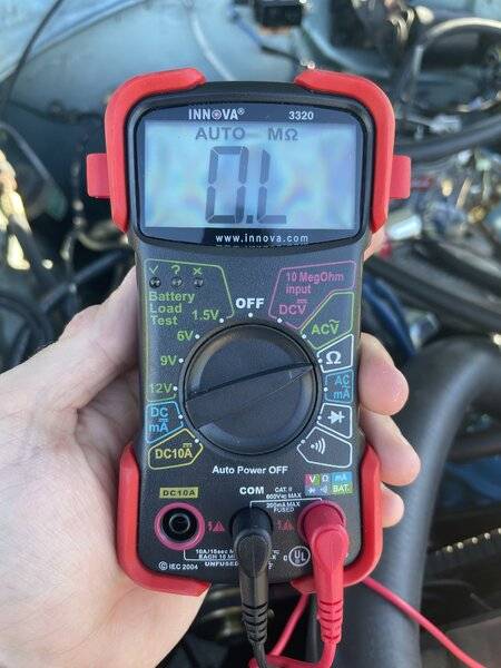

4v on left of ballast, two wire side. 10v on right of ballast. I’m not getting any ohm reading on the coil. Not sure if my multimeter is set wrong.
You have the wires off the coil? Then hook to + and - ? The reading your getting is open circuit. If you testing correctly your coil has failed
Need a close up picture of the points too. Let look there and make sure we have no issues once we get a coil that reads correctly

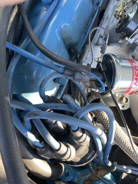

This is tested with everything (hopefully) hooked up the way the wiring diagram says. I will have to make a jumper wire.

When checking resistance (ohms) the device you are checking needs to be isolated. To check the resistance or continuity of the coil you must disconnect the wires from both the postive and negative terminals of the coil.
Ah okay. I'll try this.
