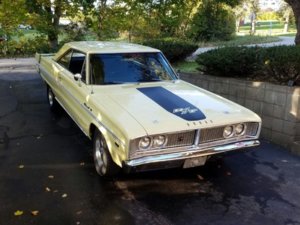

1966 coronet 440 383 4spd/ rebuilt is a dog need suggestions
it has small tube headers. the machine shop that assembled the motor stated 10:1 cr used the .40 replacement head gasket. i ask them to use a .20 shim if needed to get 10cr tomorrow I'll start checking cylinder psi, vacuum leaks again i know I'm just missing something silly appreciate the help
