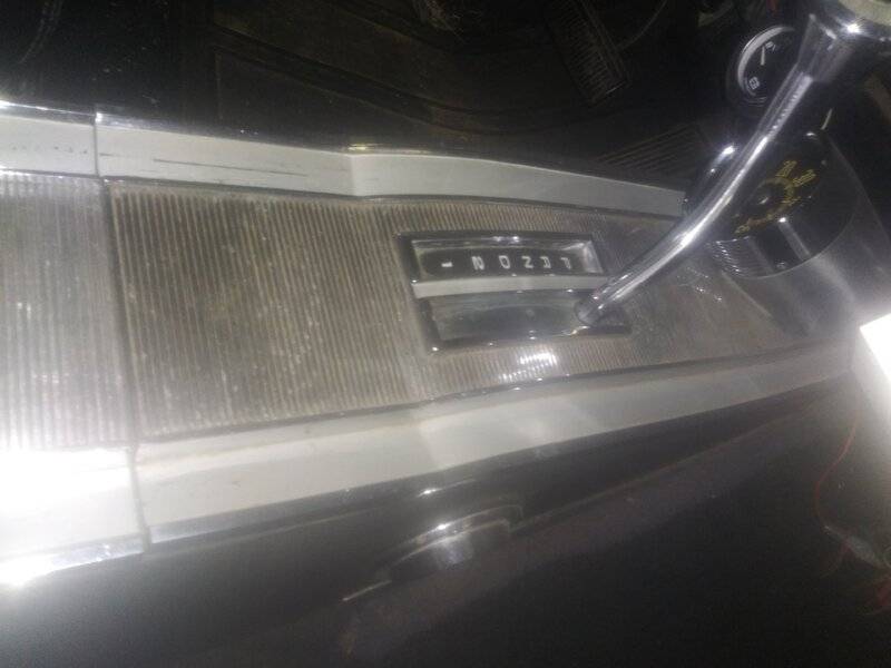

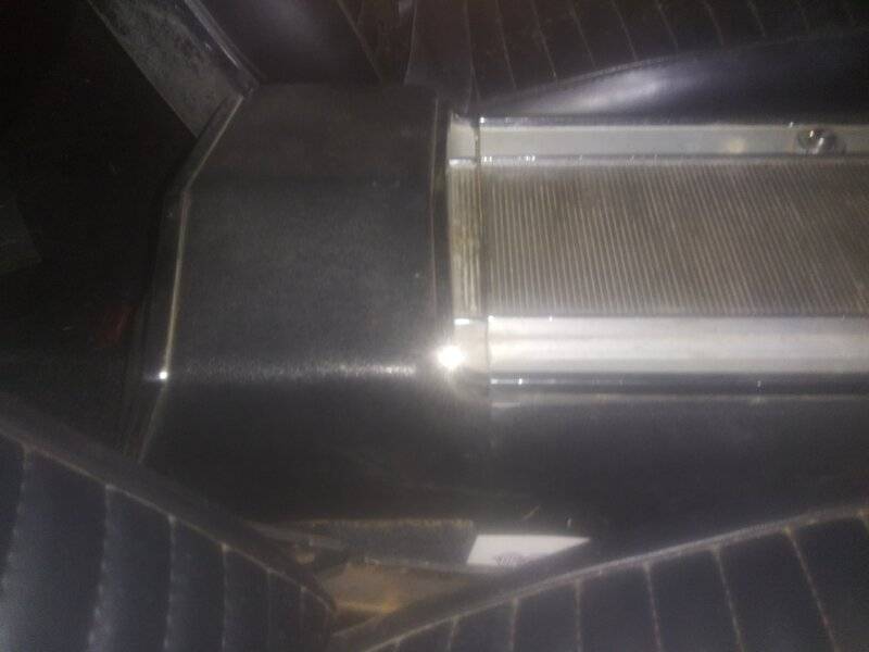

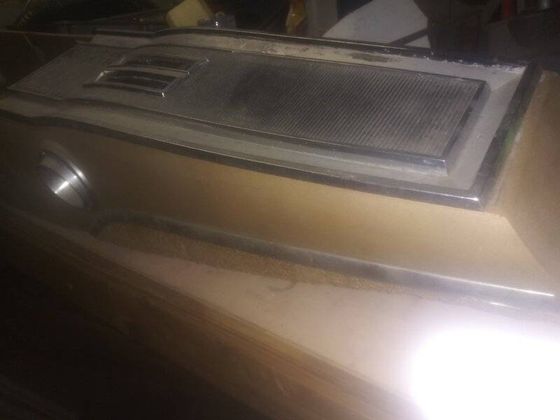

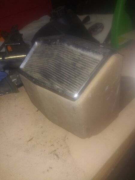

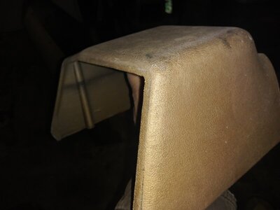

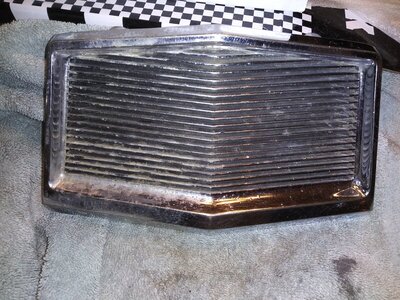

Here is the console I'm restoring to install in.my car. Many years ago, a date broke the end-piece on my original console. She wasn't my date after that! My replacement console came from a '68 Charger, which is one piece, versus the two-piece '66-only bit. In 1996, I came across three consoles. (one red, two tan), all '66s. I simply stashed those away for future use...24 years later! I'm motivated to install a restored, correct '66 console back in the Coronet. So first thing is the console restore/replace.
Pictured is the tan base and butt. I'm restoring the chrome bits on the pieces currently in the car, and using vinyl matte black paint from SEM on the console body. I'm going to practice on the other tan console first, as it has a big hole in the bottom of the console itself. I have three doors, three front plates, two shift indicators, two butts, seven interior lights and three end plates to choose from, plus six of the side trim pieces. I may sell the one-piece console base, as a complete, ready-to-install console with the best of the chrome I don't use for my restoration job. sometime in the Spring.
I'm going back with the silver painted areas along the side of the ribbed pieces, plus black in the ribbed portions. My original console top has the factory tach. Since none of the other top plates are drilled for that, that part on the car will remain.
And it'll shine like a diamond in a goat's *** when it's done!

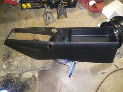

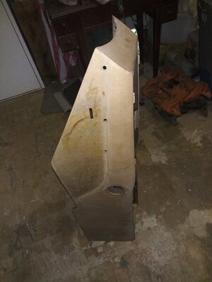

The tan console cleaned up well. I stripped it of all attachments, then I put it in the shower, washed it with Dawn and a wet rag, and dried it off. I took the end plate and the light housings, and ran them through the dishwasher. A little chrome polish will shine those right up. When it warms up later in the week, I'll paint the console body and the console top plates.
No cracks or anything. No missing fasteners. This is gonna look good when it's assembled!

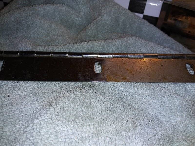

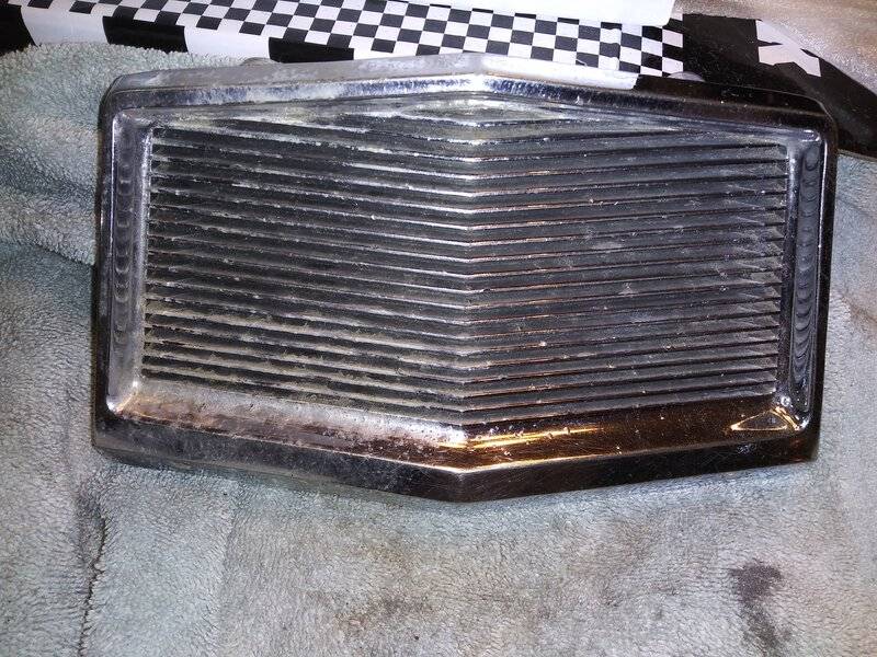

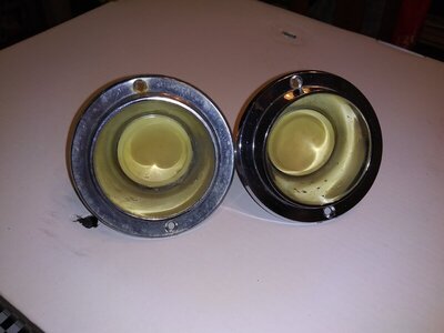

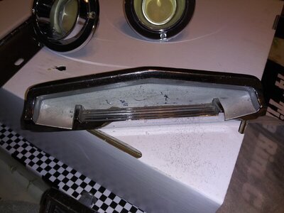

Polishing away on the chromework tonight. Nothing more than 0000 steel wool! It is coming out very well, especially the lights. The butt parts have minor pitting, the rearmost being the most pitted. Not bad, though. The visible part of the hinge looks great!
In the pics, I show the parts half polished/half as-pulled.
20201216_193011.jpg 20201216_194432.jpg 20201216_193759.jpg 20201216_195750.jpg
Doing a good job with your polishing but those are most likely pot metal. You won't want to heat them up that much for clear powder or they might blow up into a minefield of bubbles.
Check out the MC Series ceramic clear coatings from NICIndustries.com. All you need is an HVLP gun with a .08 mm tip. I've been using MC-160 on the occasional buffed and polished parts I do for customers and it's awesome.
No intent on powder-coating, I've seen the resulrs on pot metal before...pretty evil-looking.
I'll look into that clear-coating you've mentioned.
Ummm okay.
You'll be happy with the CeraKote.

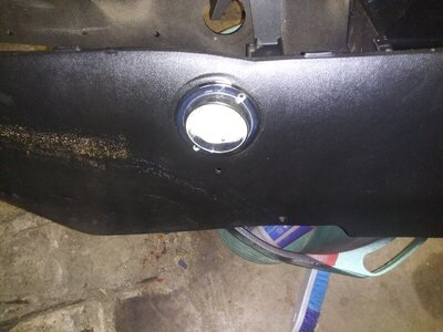

I have the main body and the butt done, and have attached the two, plus the console lamps. When my silver paint arrives, I'll do the top plates and shoot the black, too. I dyed the carpet bits from the sides and butt off the red one. They came out nice. So, it's wait, paint some more, and swap!

I'm talking about that carpeted stamped metal plate UNDER the console butt to.powder-coat.
And I was talking about your door handles and other pot metal. We suck at mind reading. Lmaoooo!!!
