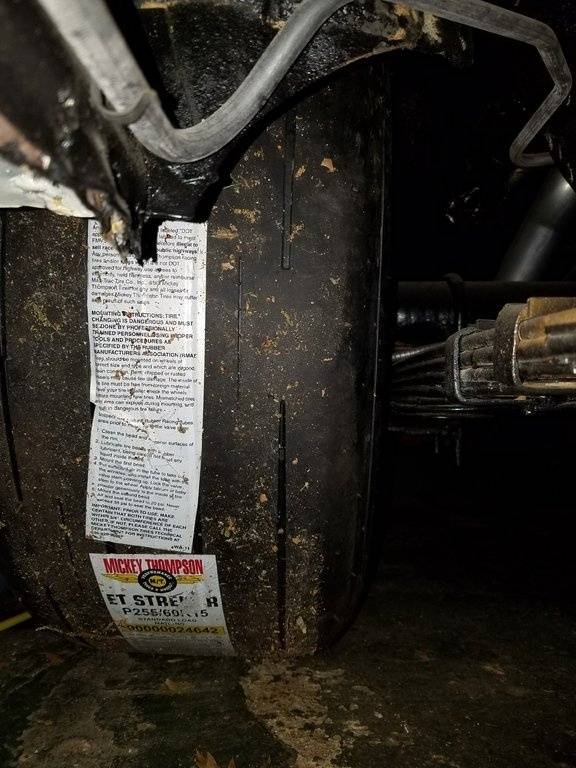

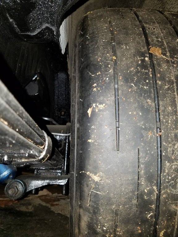

folks, anyone know what the backspacing is for this model or an accurate way on how to measure it. i had previously gleaned 4.5" from the forum in the past, but need to verify. my ET Street R tires sized P255/60-15 fit on one side but not the other, so i'm considering if i can get wheels with additional backspacing to help resolve the issue.

hmmm.....it really looks like i maybe able to increase my backspacing, see attached. i do think that '66 has less room than the 67's. i will need to take the wheel off and measure from the front of the drum faceplate up to the leaf springs and interior wheel well.
View attachment 427581 View attachment 427582
