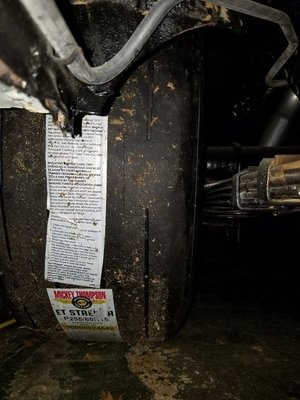

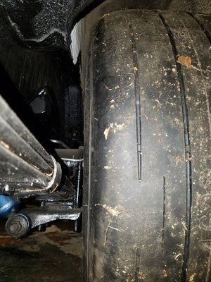

hmmm.....it really looks like i maybe able to increase my backspacing, see attached. i do think that '66 has less room than the 67's. i will need to take the wheel off and measure from the front of the drum faceplate up to the leaf springs and interior wheel well.
View attachment 427581 View attachment 427582

I have a '67 Coronet and am using 8.5" CenterLine Autodrags with 4-7/8" backspacing and a 255/70/15" tire. It fits with no rubbing (just missing by a few sheets of paper in thickness :)). I also use Poly bushings in the leaf springs so that helps as well.
I'm running year one rallyes 17x8 with 4.25 of backspacing, 275/60 tire it's super tight to the fender but I have room on the inside.
