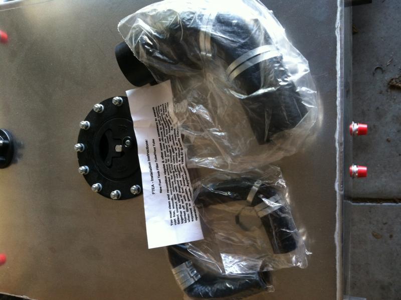

I had to buy a new gas tank for my 1966 Coronet 4 door. I'm having some difficulty finding the molded hoses for both the filler and vent. Also not sure who to get the gas tank filler tube gromment from. This factory gas tank hose/vent assembly is "different". Any help or installation tips would be appreciated. Jim
Should be the same as my '66 Charger.... in that case, I got a complete set that consisted of the big elbow, 2 little elbows, and all the clamps off of flea bay, but if you're looking to just order off of a site I know Jim's Auto Parts has it (http://jimsautoparts.com/fuelpart.htm).
As far as advice on getting the old stuff off.... side snips and a sharp box cutter worked for me :D
On the small elbows for me, there was extra length on them that I had to cut to fit, and keep in mind that where the small elbow's hard line goes through the frame that it won't fit with both elbows on it, I stuck it through the hole before I put either side on
I have a set that I'd get rid of...decided to put a cell in my car and don't need these any more...PM me if you're interested...
