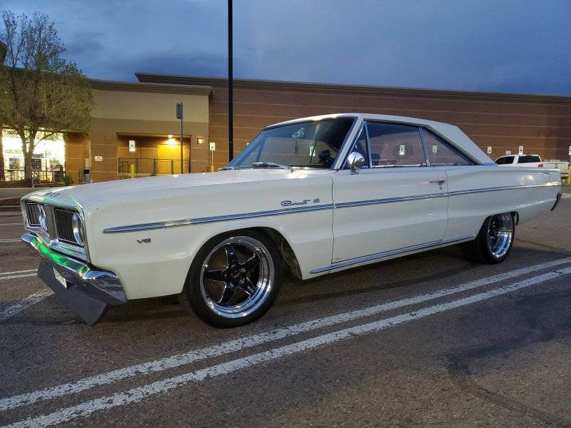

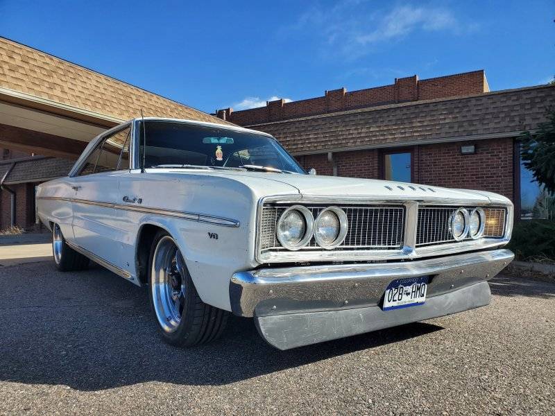

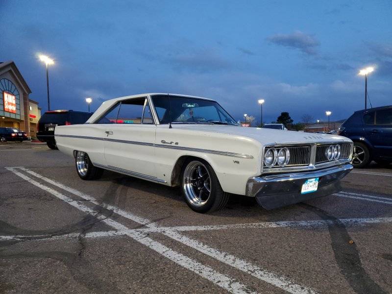

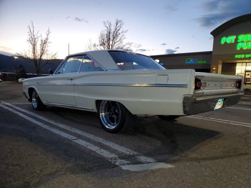

'66 Coronet wheels
Weld S104
18x9.5 - 0 offset - 265/35R18 rear
17x7 - 0 offset - 205/50R17 front
also pretty confident that 275/35R18 would fit in the rear
^^^Diggin' the air dam on your '66! Did you make that from scratch, or modify an existing dam to fit?
