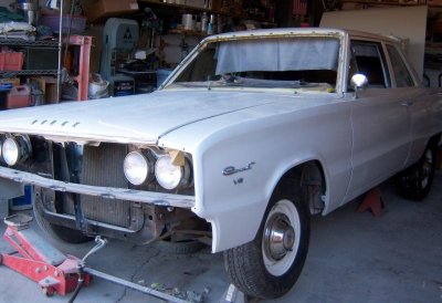

I will be cleaning up and doing some restoration to this Coronet. I've had this car for about 15 years and it's finally time to give her some past due attention. This isn't going to be a full blown every nut and bolt "over" restoration project. The car has 42,*** miles on the clock and is a pretty original for it's age.
The car came stock with a 273 AT 8 3/4 rear. I removed the 273 and small block transmission and dropped in a mildly rebuilt 400 with KB pistons and the 375 hp cam along with a set of 915 heads.
I did this many years ago and at the time didn't have the time to do any paint work on the car.
It's time to get to work on the 66 project and get her back on the road.

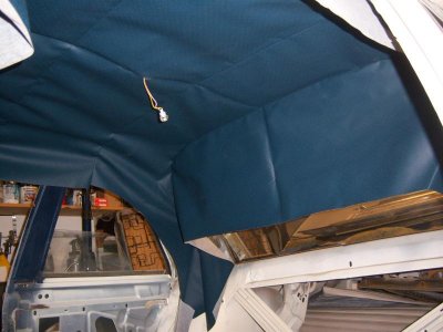

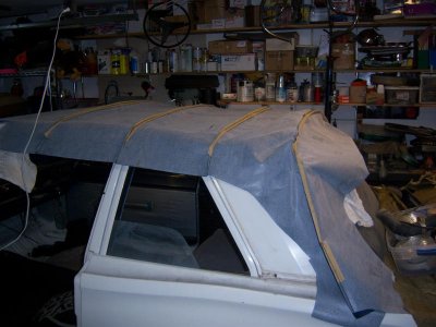

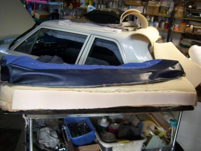

After gluing in some insulation to the inside roof panel the car is now ready to installing the headliner.

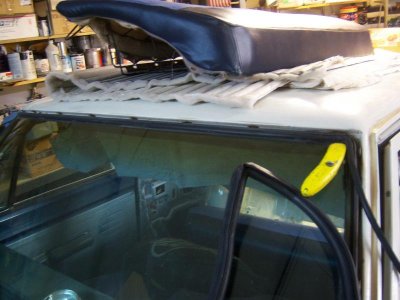

After receiving the headliner I inspected it and all looked good so I laid it over the roof of the car to relax some of the folds over night with the heater turned up. I then fit the bows to the liner and hung it in car after cleaning and painting the roof panel.

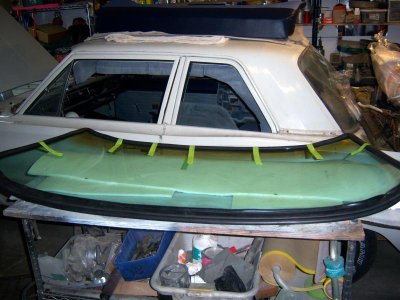

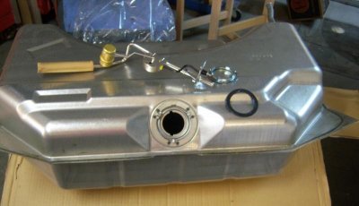

Finally got the fuel tank , 3/8 sending unit and windshield gasket now time to cut the glass out after I checked to see the gasket was correct for the 2dr sedan

I fit the windshield gasket to the glass so the gasket will straighten out and stretch out which should make it easier to install when it's time to install the glass in the car. I've tried it both ways and what works best for me to have the gasket installed to the pinch weld then sit the glass in the gasket and lip the glass into the seal with a windshield bone and a little hand soap as i go around the glass.

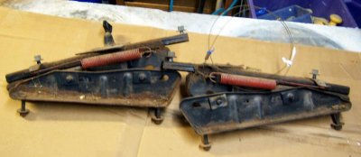

The seat tracks for the bench seat needed a little clean up but like about all the other parts I've been cleaning are in like new shape. I used a little brake clean to get the old grease removed, some comet and h2o with a tooth brush and painted after killing a little rust on one of them.

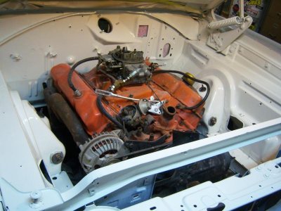

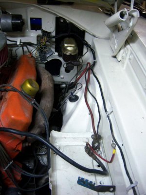

engine compartment preped and painted
engine compartment is now painted with single stage urethane after several hours of cleaning and prep with scotch brite, 400 grit then cleaned before painting.

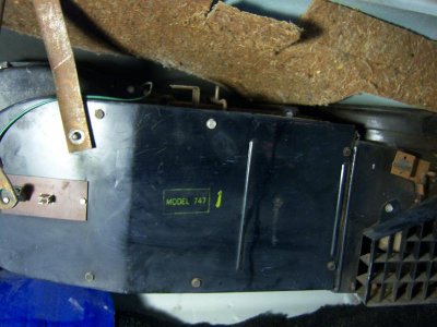

After resealing the wiper transmissions parts will be going back on the car.

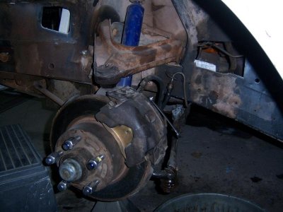

Installed a set of disc brakes and along with the lines and distribution block to upgrade to dual reservoir master cylinder.
all the parts were a simple bolt on project just needing a couple fittings to go from 3/16 to 1/4 flare.
the parts came off a 1976 Dart if I recall now time to do a little clean up and paint the parts.

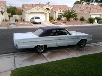

Hi Rodney,

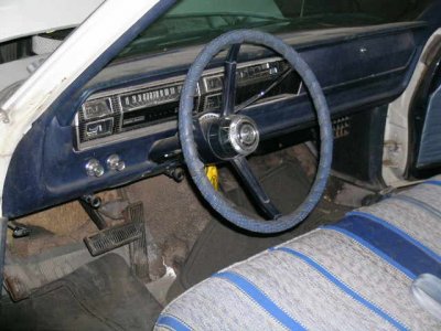

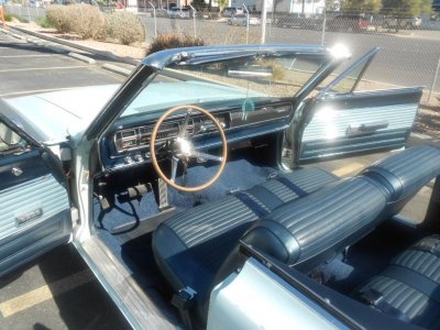

Dig the car, subscribed - I have 2 '66 Coronets myself, 1 HT & 1 conv. I noticed that your steering wheel is not on the car. Do you have the original wheel? are you going to use it? If not would you consider selling it?
Thanks.
Hi Rodney,
Thanks.
I'd like to take a look at your cars, do you have some pictures? I'll bet the convertible is a rare one!
The steering wheel is the next part I will be restoring, filling the cracks and gaps and painting.
I will look in my parts, I may have another wheel for you.
would you know if one from a 66 Dart would be the same?
I have a couple of those as parts cars.

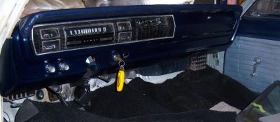

I pealed the old hard cracked vinyl from the dash pad, glued some 1/4'' foam to the existing padding to cover the ugly cracks after filling them with some latex calk {it was handy}. I then used some of the vinyl I had left over from the seats, sewed an upper and lower piece together and glued it to the pad. It would have been nice to buy a new pad but funds are limited so I did a poor mans restore on the dash. This is how we would have fixed it in the past before a new one was available. Even tho I am trying to save as much of the original paint I had to freshen up the paint on the dash as well using some under hood paint that was left over from a job at the body shop. I'd guess the total cost of freshening up the dash was under 20.00 and a few hours time. When the funds are available I will get a new pad but for now it is good enough. As I went back together all of the electric plugs got a good dose of dielectric grease to protect from rust and corrosion.
before
after
I'm not sure if a Dart wheel is the same or not. I'm trying to find a nice original wheel, blue in color, I saw your interior and thought I'd ask. Mine is very badly cracked. Your dash came out nice. Here are some pics of mine -

now I wish I had went with a blue carpet after seeing yours.

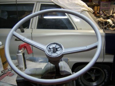

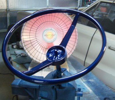

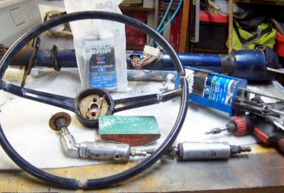

steering wheel restore
I first cleaned the wheel with wax and grease remover then windex.
using a die grinder with an aluminum cutter I "V'd" out the cracks and voids to accept the repair material
Valvoline Plio-Grip #3 is what I used, after it dried I sanded with 80 grit then 150, 220 and 400 before priming.
after the primer was dry I fill the smaller voids with plastic filler. sanded and primed again then painted with the paint I had left over from the dash. this seemed to be a successful repair, time will tell. cost about 20.$ and a few hours time.

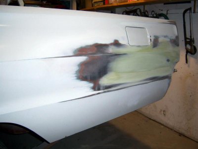

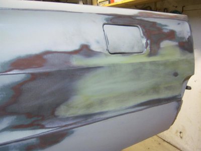

1/4 panel body work and prime
I have been fortunate that the paint on the car is in real good shape so stripping is not necessary and I am going to save as much of the OEM paint as possible.
I sanded the paint off the repair area with 40 grit on an 8 inch feather edge pad.
after the scrape was dinged out I filled with plastic sanded with 40 then 80 grit using my sanding boards.

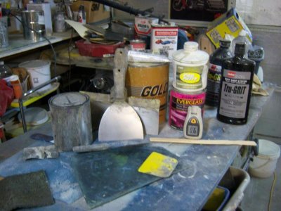

One of the most important tools on the bench is the digital thermometer to check the temp of the panels and materials I am using when working in the cold, even tho I have a pretty good forced air heater it doesn't warm the panels up enough for me. I use an infra-red heater and bring the panels up to around 70 degrees before applying any material.
I also check the temp of the plastic and carefully heat it up before mixing the hardener, this eliminates pin holes and makes the material go on nice and smooth. The smoother the plastic goes on the easier it is to finish.
after the repair was ready I sprayed a guide coat on the plastic and sanded with 150 to finish before priming.
The guide coat brings out any low spots and make finishing the style lines much easier.
I prefer the dry 3M guide coat product but was out of it so used a fast dry primer.
I sanded the broken paint edges with 150 then 220 stepping it out. Mask, cleaned and primed with Nason 2K primer.
Next will be block sanding with 400 and paint.100_5380.jpg100_5389.jpg100_5382.jpg100_5394.jpg100_5395.jpg

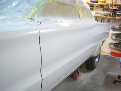

After a guide coat was sprayed on I blocked the primer and sanded the OEM paint with 400 grit masked and applied 4 coats of Lacquer paint from Global, let it dry an hour sanded with 800 grit wet and applied 4 more coats of paint.
I am using lacquer for ease of blending and to retain that OEM look and it is much less toxic to handle and spray.
My garage has an exhaust fan and I am using a shoot suit gloves and respirator when spraying all of the materials
If I were using a urethane 2 part paint I would not attempt spraying the exterior at home. I did using urethane on the engine compartment which is much more durable and will hold up much better but wouldn't attempt spraying much more area without a spray booth.

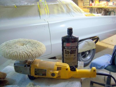

After the final coats of paint dried it was time to polish the paint, for this I am using a wool pad and Tru-Grit compound.
total time start to finish about 6 hours and an hour polishing, time to assemble and move on to the other side.

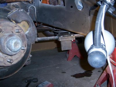

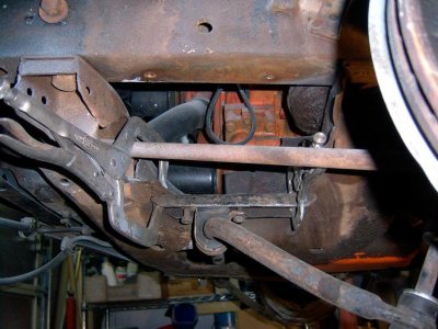

Sway bar install.

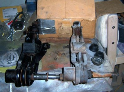

The lower control arms didn't have the mounts for a sway bar so I cleaned up and installed new bushings on a pair from a 1970 B body station wagon I parted out years ago.
control arm installed
I had to notch the K member {above the sway bar} for the sway bar to fit and drill 4 holes for the mounts to the K member. Pretty simple job with huge benefits for hwy driving and will help eliminate the front of the car from diving when braking hard.
