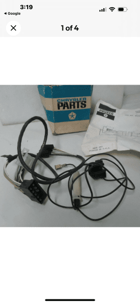

Can you send me a picture of the Harness any way you can do that? Would appreciate? Does it look like this
I am looking for only the Harness. The switch is simple. I am mounting it on a Chrome plate with a hole in it. Not cutting the dash! Although the Dealer does show how to drill and where they did infact drill three holes for mounting the switch left of the steering Column. I don’t care about the E-Brake Light.I have a 4 Speed Car and common sense has to be used! The Emergency Flasher is again Common sense as if I break down I don’t need some California Rookie running into me! Thanks again I spoke with M&H today they say if I get a switch it can be made. We left it at me acquiring a switch or detailed picture? He seemed to understand knows how they are wired but really needs a very good photo or the original to be reproduced.And would it not be nice to have four way flashers for the safety factor?
there is / was an nos harness on ebay
i may have an nos switch,

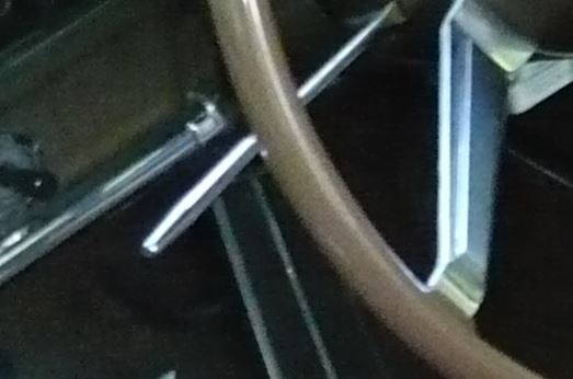

Does anyone have a picture of where the 66 4 way flasher switch is located? As far as I know there isn’t any relief in the dash for a switch like a 67.
Mine is to the left of top switch, look to left turn signal lever.
