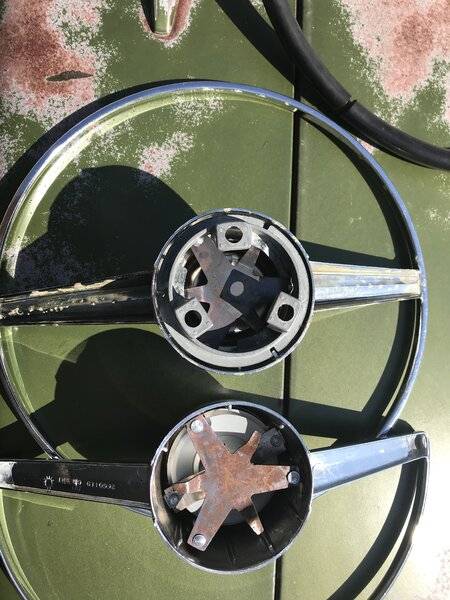

This is what it looks like from the back side. Coronet is the top one, notice the lock tab at the 5 o'clock position in the center. 66 Satellite is the bottom horn ring and the lock is in the same position

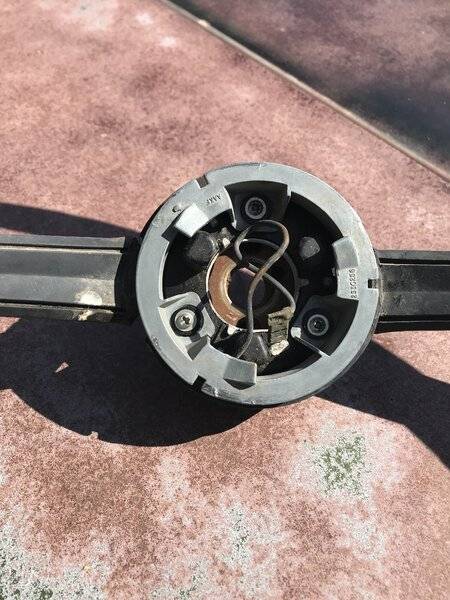

Removed, the shiny spot along the edge if the ring shows where the lock tab has been rubbing when removing the horn rings from the wheel.
