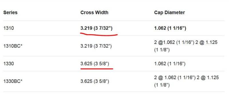

May have solved the 1966 pinion yoke situation. I have not found that a 7260 pinion yoke existed/exist with 29 splines and involute splines as found in Dana’s.
A Dana 60 in a mopar muscle car car never came with a 7260 U-joint.
