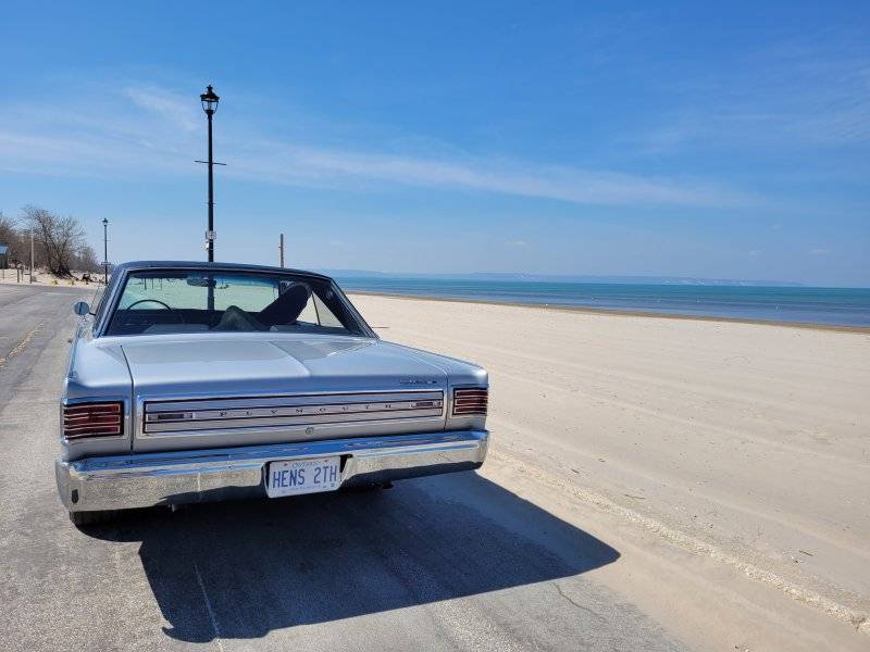

I was told there was a difference between the rear bumper on these 3 models, anybody know about this?

There is no difference in a 66-67 Plymouth B body rear bumper. If the car was equipped with optional bumper guards, there would be a few additional holes on each side.

The only difference is the optional bumper strips. Same bumper and drill holes.
Same brackets
Same mounting to the car
Same license lamp
Same rubber strip on the body.

With and without bumper guards. No difference I know of
