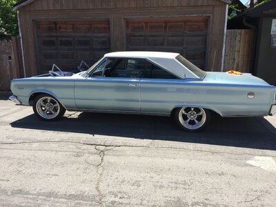

Hello, I had a look for tire sizes that fit a 1966 Plymouth Satellite with 17" wheels.
I found lots of great photos but no sizes listed.
Could you guys with 66/67 Plymouth B bodies running 17" wheels help me out with photo and sizes?
The car original had 235/60r15 and 255/60r15 and look/fit great, can't find 17" tires in those dimensions, so this leads me here for help. I could go a little taller but don't want shorter side wall. I posted a pic of the 17" wheels, the 235/45r17 and 255/40r17 rear is shorter then front, not looking good.
Thanks for help.

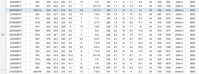

I don't have any pics for you, but if you're planning to leave the 235/45s up front, maybe take a look at a 255/50R17 for the rear. It'd be *roughly* 3/4" shorter and narrower than your average 275/60R15, so pending your wheel specs, should fit a 66-7 B body. The chart below is for Federal 595 tires, which I have not personally run, but have heard good things about for the cost. 5th column below is overall diameter in inches, 7th column is section width in inches.
