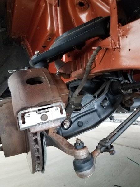

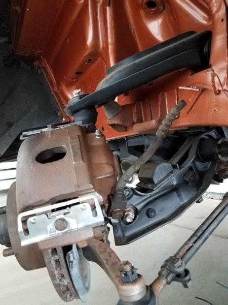

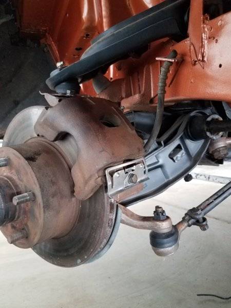

More information om my brake conversion parts that I have from the previous owner.Andy is a member here as well.
I have the tall big-bearing knuckle with a small slider caliper adapter H.D version.
The caliper is a rear mounting style with the large single piston with 10.78" rotor.
After reading Andy F. performance upgrades and Disc-0-tech (excellent information)
I'm confident of what I have. Now to move on with brakes hoses.
Huge difference in distance in the lines when the wheel is turned.
This was stated as a problem possible being rear mounted for brake lines.
Note sure why the previous owner went this way as this car was not a factory sway bar vehicle.
I do intend to install the aftermarket sway bar (Addco) I think it mounts to the shock mounts.
If not I would have to move the knuckles to the other side then purchase front mounted calipers.
Then more problems with the sway bar being in the way. Don't really want to do that...if I can.
Not sure if their is a small big-bearing knuckle that would work with what I have now that might
give more clearance for the hose line by maybe lowering it or have to purchase a rear mounted caliper
with the hose connection on the bottom of the caliper instead of side/bottom to keep the line from pinching.
Looks like I have a good set up to me....anyone do this to a 1966 B body.
