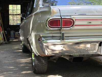

Can someone clarify how the trunk panel on the 66 Satellite was trimmed out with paint accents? Pictures of originals would be great. The one on the car I'm going to be working on has been re-anodized but the paint accents were not replaced. Most I see have a red paint in the recess in the top, bottom, and middle of the panel and the end recesses connecting the horizontal areas on the sides. But, I've seen at least one picture of an original that looked like inside the two rectangular sections isolated by the red stripes, the panel was painted with darker argent gray or something. Here is an example:

Last picture is correct. First one was taped off and painted, mo. Originals look sprayed but edges aren't crisp, like an air brush. Picture rear of my original piece. Can't see line across bottom because of camera angle.

Edited post twice. The last picture and on mine you can't see line on bottom, camera angle.
Thanks - that confirms what I thought was most likely correct. Anything particular about the color - just red-red or dark red?
I'd say it's a dark candy red.
I say Candy too. It is translucent so you can see the aluminum underneath. Mopar did that a lot in the 60's and 70's. Here's my 66 Dart. Same treatment.

One more question - approximately how wide are the stripes of red? I'm guess 3/16 to 1/4"??
If nobody measures by tomorrow I'll do it tomorrow. Close up pic.
Fran - is your trunk panel paint original? It matches mine to a tee. Kind of a pinkish/purple after 54 years.
Yes it's original. Have a NOS one the red is darker. Did some inventory work in spring, if I remember and pull the sd card and post a picture.
