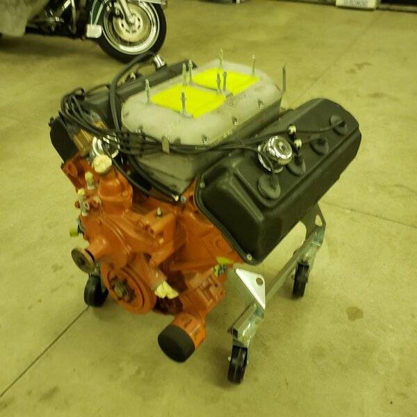

Hello I have some NOS Schumacher conversion mounts to use with my V 8 K member. My Hemi is a mild build Rat Roaster manifold. I am considering a set of stock exhaust manifolds and an accurate exhaust system . Any thoughts on where to get stock exh manifolds new or re pop or suggestions on headers?
