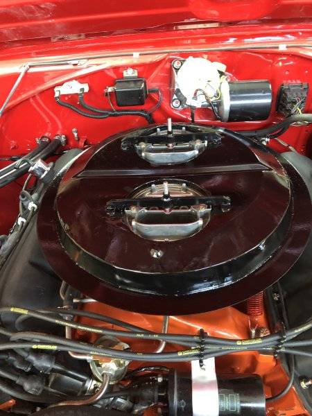

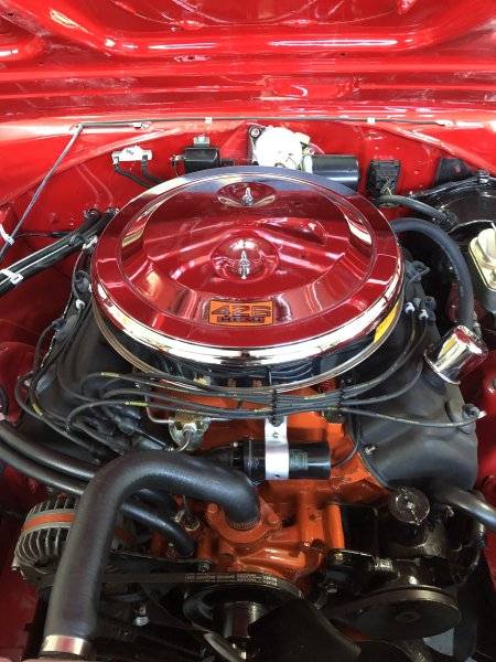

Stowe , actually I just did it last fall the Schumacher mounts are awesome the motor and all fit perfectly , even with stock exhaust manifolds I was going to use the rat roaster also but the carbs sit way too high ,went with the Edelbrocks on the stock manifold and modified the factory air cleaner base . Took 5/8 inch out of the base and the air cleaner element still worked . Very carefully with a few micro fibre clothes laid over the air cleaner to close the hood when done to make sure . Watch the height of the carb studs to prevent dimples on hood Lol

I would be concerned about how much airflow is effected by your drop base design.... It looks like most of the element is blocked... I would at least try modifying the sides to taper down to expose more element to airflow...
Nope exactly the same area as factory lowered the air cleaner over the carbs the air cleaner is round not easy to modify that
I just searched Hemi Dome air cleaner, never noticed that before.. Looks like some have a little more taper but not as much as I would think it should have..
My hemi was a 71 so it had the oval style air cleaner... Sure seems like that design it blocking a lot of air...
