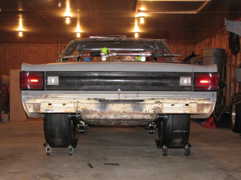

We are setting this car up to run in Drag Week deep into the 8's (car will only cert to 8.50) on the drag radials (315 x 60 x 15's)
My brother and I built the cage, installed the engine, trans, rear, did the wheel tubs and the other body mods. We did get to drive it in the addition before he had to leave on drag week, we didn't have any lighting done on the car or the belts mounted. This is one very bad street car.
This is where we where after much cutting and some mockup. What you cannot tell is that is not a rear in the car, it is a tube with plates welded on just for mockup.
