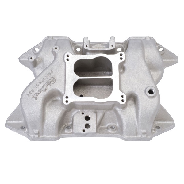

I need some help with a project. 10 years ago I started collecting parts for an engine project. Project got put on hold and now is being resurrected. Back then I purchased a Edelbrock intake that specifically called out "383" on the casting. I am building an under the radar engine so I removed all the casting call-out's and had the manifold powder coated. Here's the issue I can't find any info listed on the manifold or any specs. Looks similar to the DP4B but specifically had "383" as part of the casting.
Any help, model # etc. would appreciated.
Performer 383
Pics would help....and the Streetbastard is just that imo.
Essentially a DP4B, flipped front to back, and spreadbore capable.
Agree, however mine is standard square bore. Guessing it was an earlier model.
You have a 383 Performer that has a squarebore flange? Mine is at least 35 years old and has the spreadbore flange.
