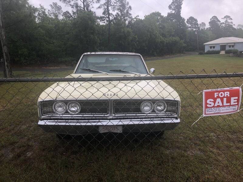

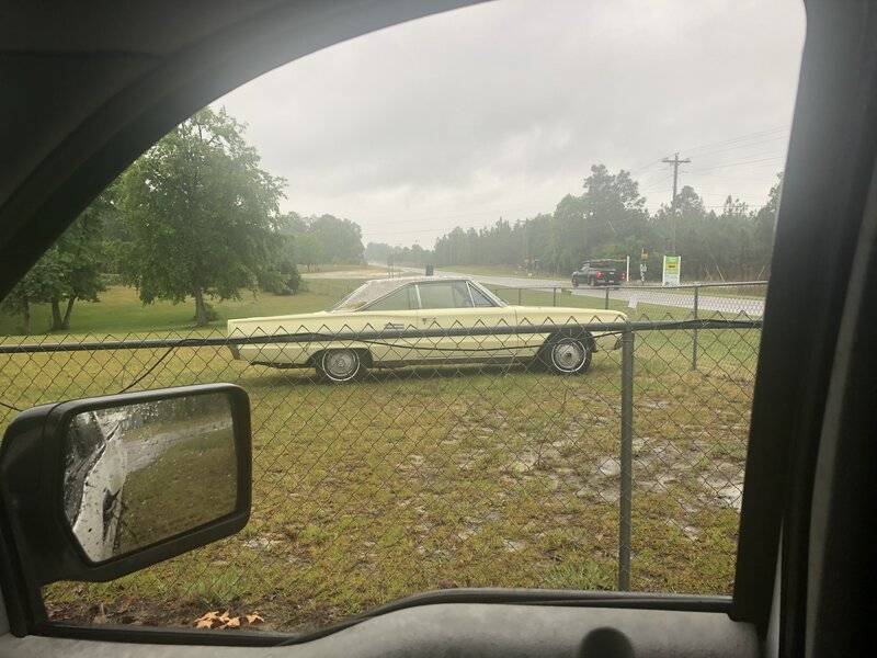

Here’s a good deal. It’s probably 4 days away not 4hrs.

Unfortunately by the time I got that home I'd be almost $20k cdn into it and I'd still have to safety it for the road. Good deal for a local.
:eek::eek::eek:
