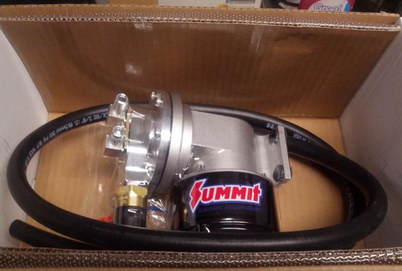

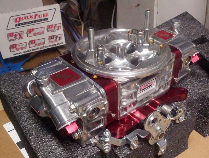

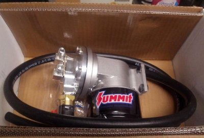

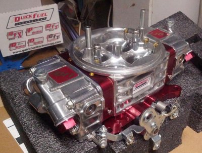

Got these today :headbang:
You're going to like that carb! I have the same one on my 512. Lot of tunability. If you PM me your email address, I have a tuning guide from Don Gould over at 4 seconds flat (48 pages). It's based off a Demon carb, but works works just as well for the Quickfuel as well.

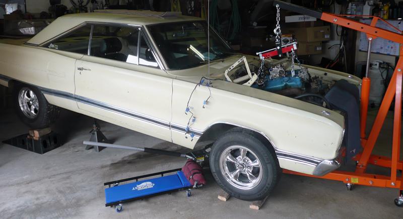

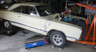

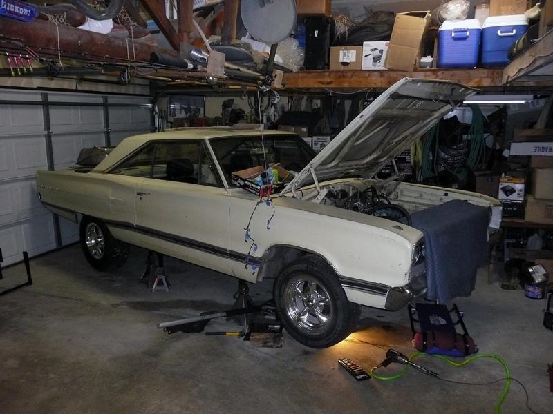

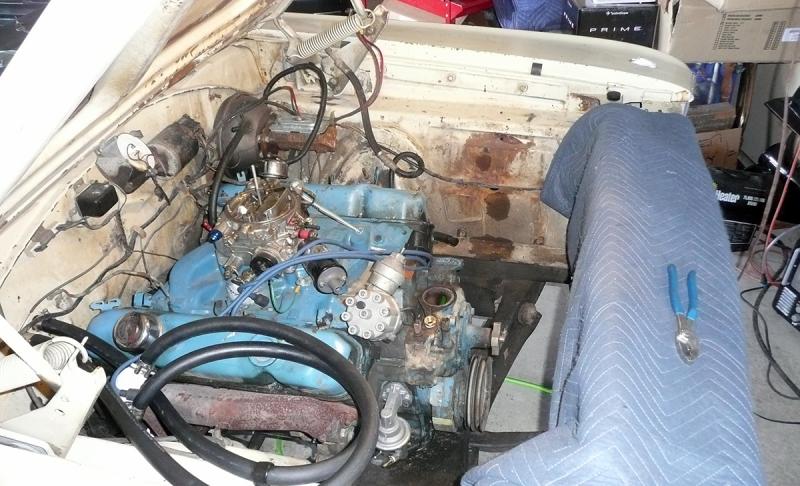

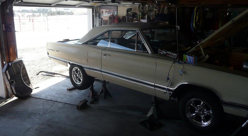

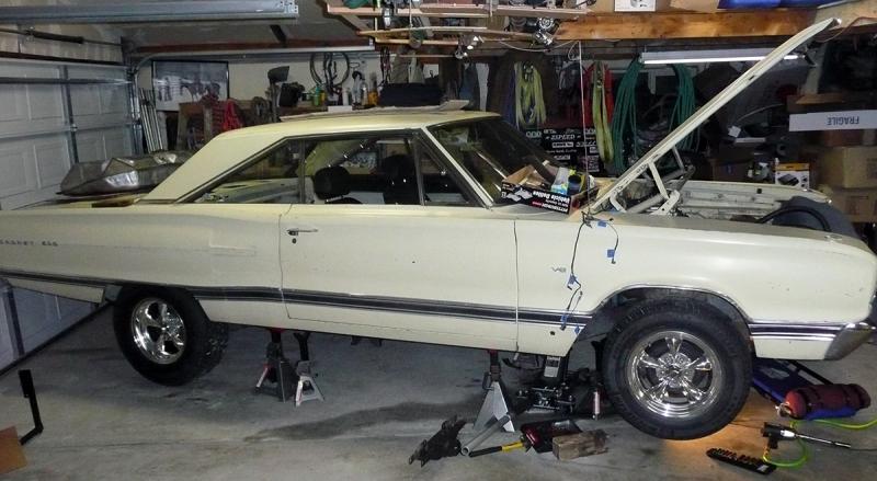

Started taking her apart today for the motor rebuild...
Should be pulling the motor and tranny tomorrow.

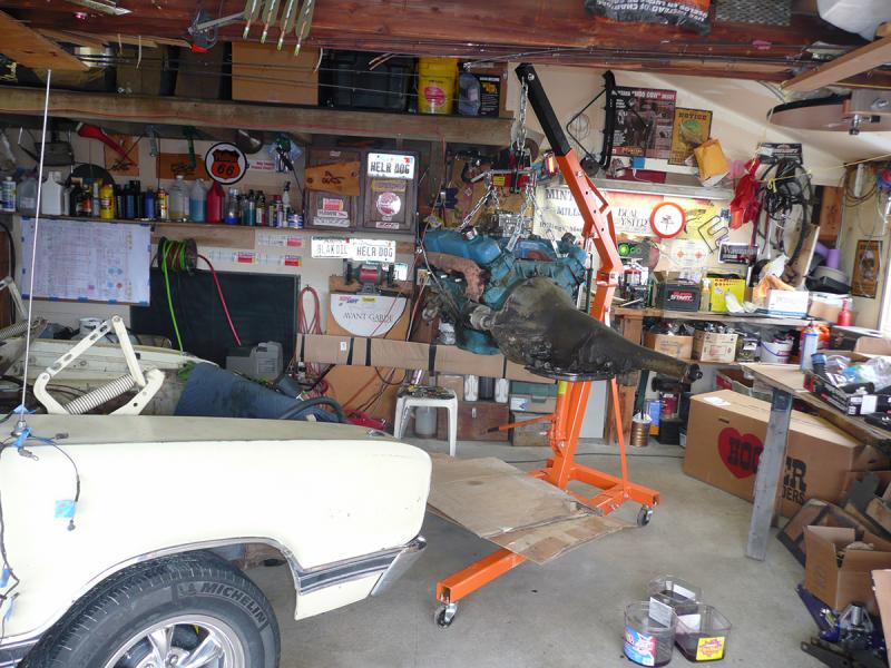

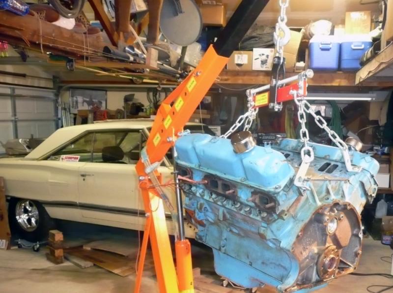

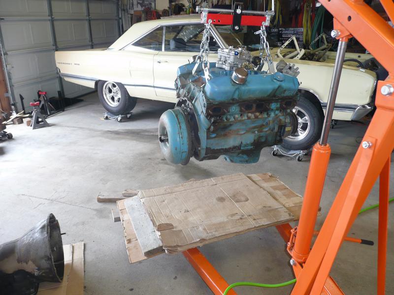

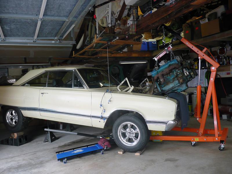

Motor and Tranny are out!
The leveler puller attachment makes all the difference in the world.

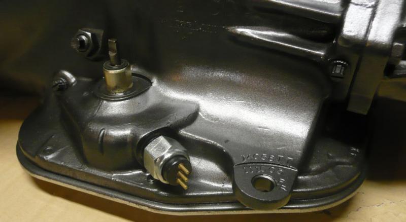

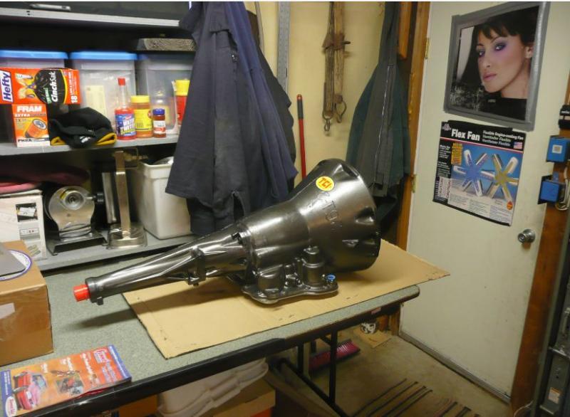

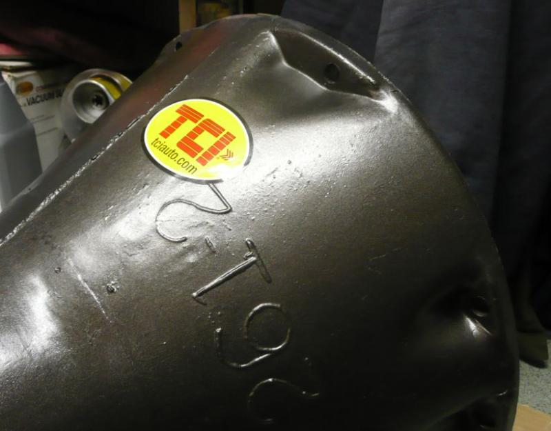

What is the finish on that 727 John? Looks really slick.
I like it .. anyone know if there's something I can duplicate that look with in rattle can? not necessarily that exact color. Please PM me
I have had pretty good luck with my SuperStreetfighter thus far John. Take a good look at the shift/kickdown selector seal. Mine leaked bad right after dumping in fluid and I ended up having to change it while in the car (nifty tool made for that). Also, check fit for the Dip Stick tube. The bracket for mine did no line up. I just cut the old bracket off and tac welded it so it would.
No idea on the color, but mines the same. Kinda a gunmetal grey. Call TCI, maybe they would tell you. Posting at 4:23AM Bryan...you're a mad man!

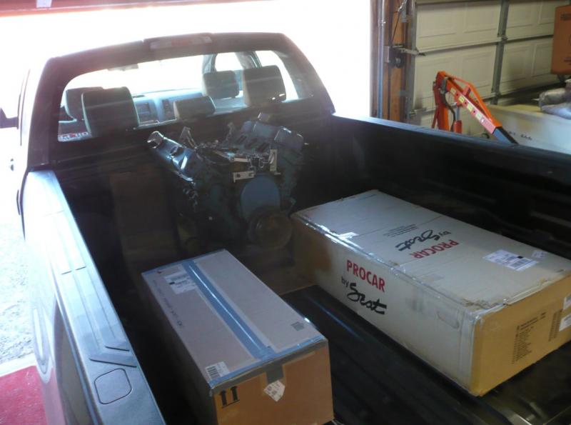

Dropped off my motor and all the parts for Jim to build yesterday. About a 7 hour drive one way, me and my buddy left early so we got to Jim's about noon.
Here's Jim and pops test mule engine, what a great guy, we BS'd and he showed us his shop and all his engine building stuff, we met his son's also. Pretty cool stuff and an amazing shop. His son is building a monster Challenger.

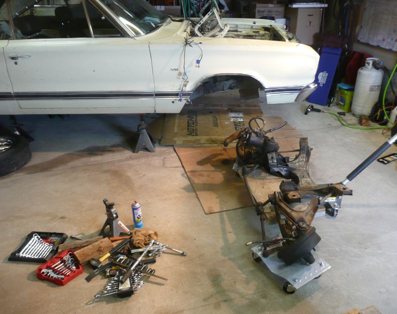

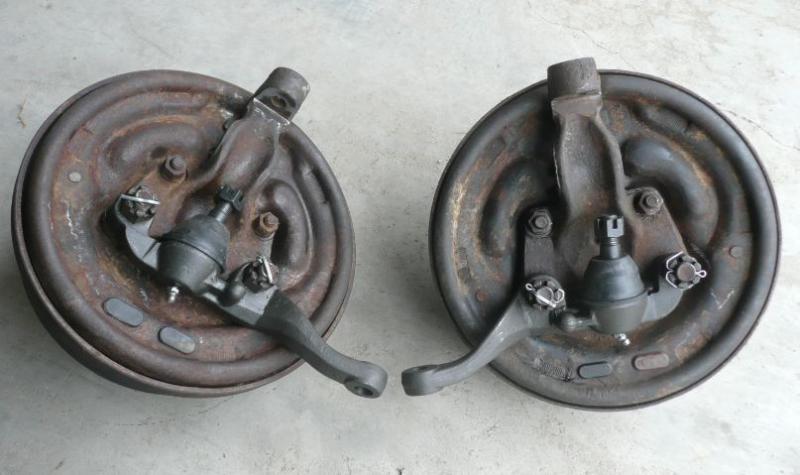

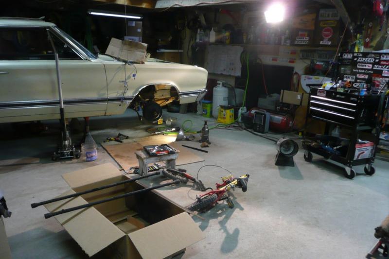

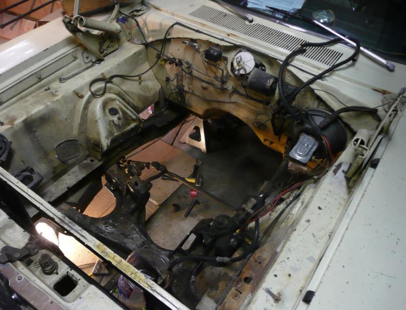

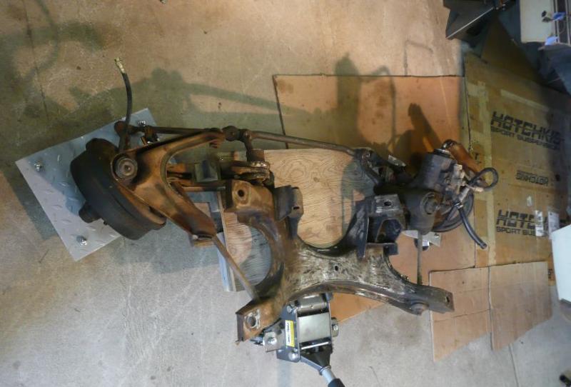

I am tearing out my K member (gotta do my front end anyway) - I have a kit fom PST.
I am going to mount the completed engine on the K member and then lower the car on that.

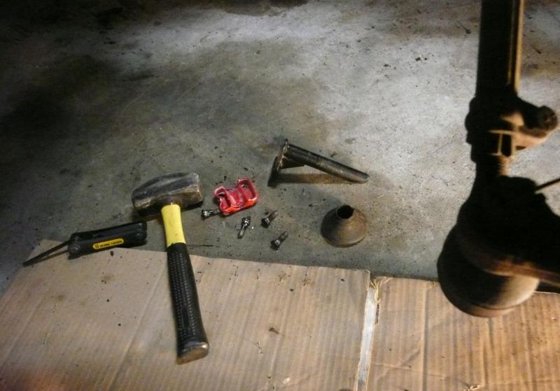

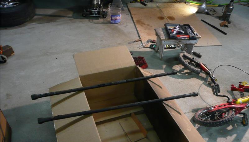

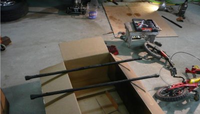

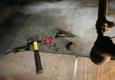

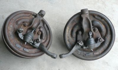

Torsion bars are out! This forum is awesome, a little reading and a spare mini BMX bike and bam! I had a torsion bar removal tool.
K member is coming out tomorrow, going to get that nasty power steering box cleaned up and rebuilt also.
