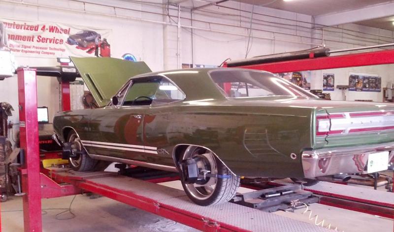

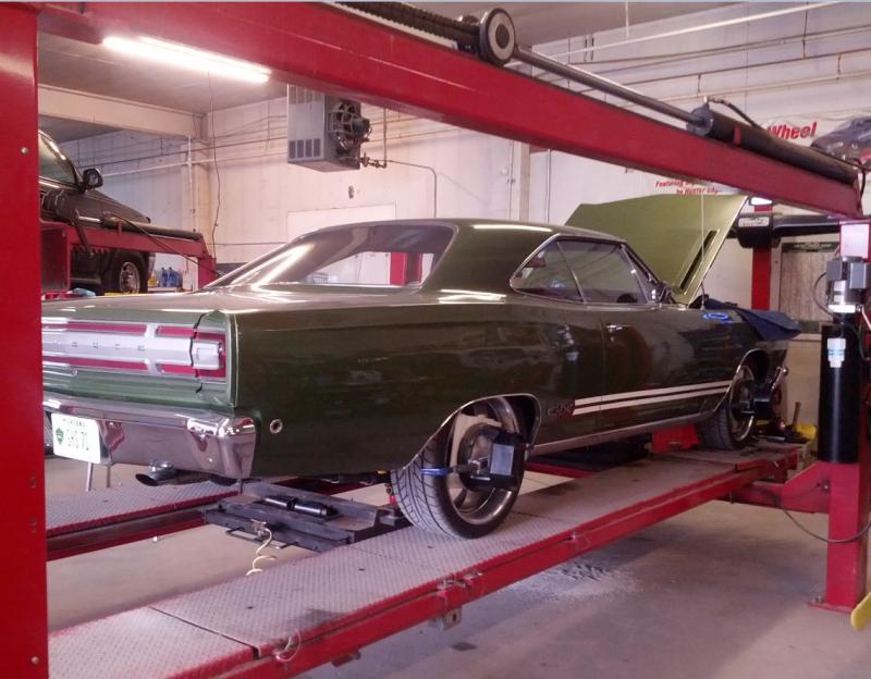

Just today, I was just casually dropping off my rear center section to my gear man and look what they had on their alignment rack... Pretty Nice huh?
Perrty nice is an understatement! Wow, envy bug digin hard here buddy, VERY nice!!
Looks like things are coming together for you, nice job on the K member. Looking good MT

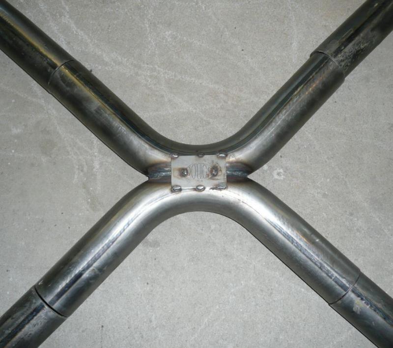

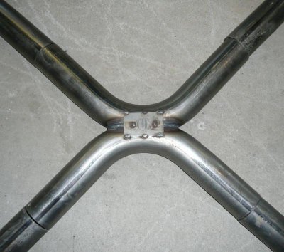

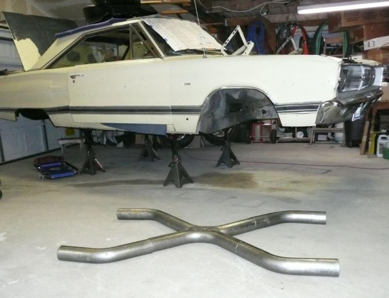

Picked up a Doug's X pipe on sale for $95 shipped... I think I am going to go with the Flowmaster 50 series 3.5" in and out.
That Doug's pipe look's pretty decent John. They make good stuff! What made you decide to go the X-Pipe route?
I would like to know as well, since talking to old timer experts (all with racing pedigree), there is absolutely no reason to run x pipes..
I wanted an even sounding exhaust, that's the only reason. I am looking for a unique sound though, that is why I went with 3.5" all the way out with the Flowmaster 50's, should be a nice low rumble. Plan is to exit in front of the rear tire with a 3.5" X 4.5" tip.
This exhaust is just an experiment and is definitely up for revision. Might go with Dr. Gas boom tubes later down the road.

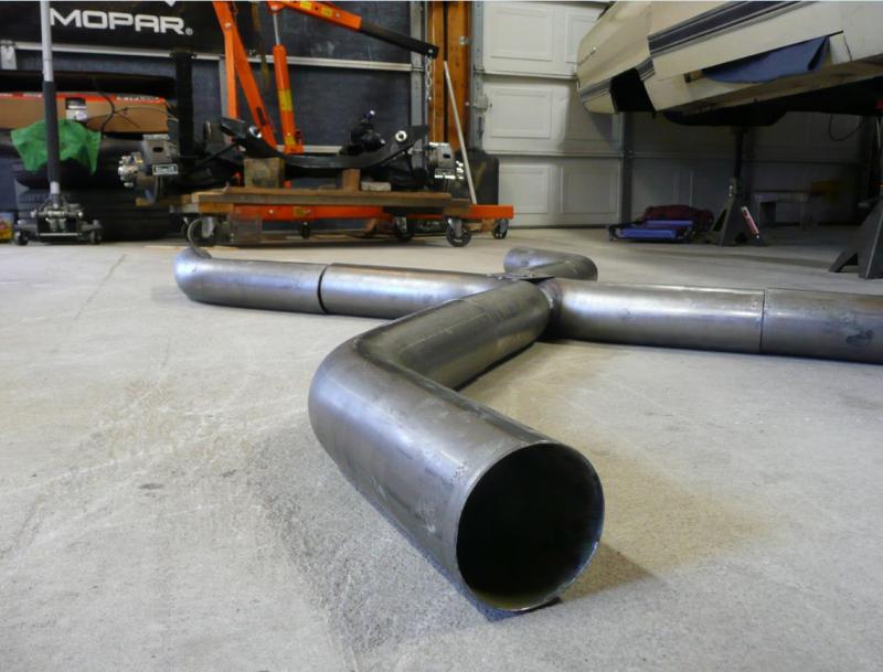

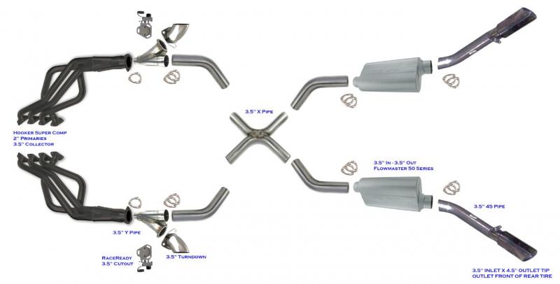

Here is my concept design:

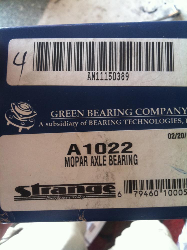

I didn't do it!!! lol.. You said you dropped off your center section for your gear man, i hope that turned out good, im Media blasting mine and want to primer and paint it when done and ill need to buy new bearings for the axles, If you've done that maybe you could let me know where you got your bearings? Its been moved around without the center section in it ( haven't got it hear) and i want new bearings when i do get the center section to make sure all is ok... If you could get some one else with the same (lets have a ball smile) to get in where you are there, you could just have him make power under the hood! :)
When I did my axles, I used Strange bearings. Part number A1022. Came with the bearing, ring, retainer plate and seal. Super easy system. Bearing are sealed...didn't have to pack them. Took the axles to the local shop for pressing. I think I paid $31 each side for these.

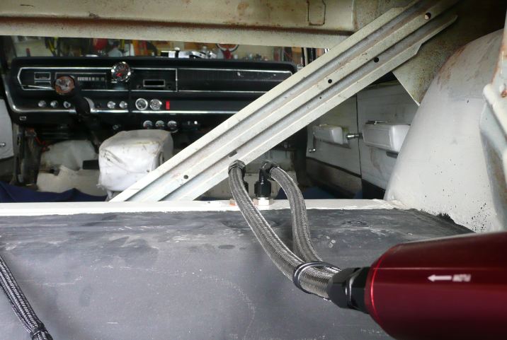

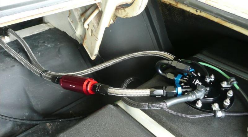

Got some fuel delivery stuff done today.
340LPH Aeromotive pump with return, 22gal cell with sender.
Still need to run the vent.
I like the idea of the cut outs..But really think about that x pipe. Most I have seen and heard end up making a V8 sound like a ricer! Raspy and thin. YOu have put so much work into this car and it has to sound good..If you want a cross over do a H Pipe instead..
Thanks for the feedback! Much appreciated.
I might initially just go straight back with true dual exhaust, that would be easier and less work also.

Well if it makes you feel any better I'll post a video ASAP of mine running with a 3" X pipe and with mufflers modeled after the Flowmaster super 40s so you can hear them, I think it's mean as hell sounding. Looking good MT

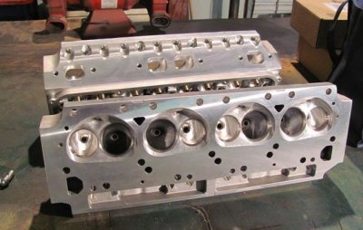

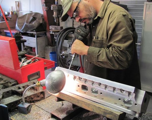

IQ52 is building my 440 motor for the Coronet, here is Cody porting my Eddy Victor heads with the before and after flow data.
Lift..............OOTB IN/EX................Ported IN/EX
.100..................60/59.......................77/66
.200................120/113...................152/142
.300................181/165...................211/194
.400................237/201...................259/237
.500................276/219...................300/270
.600................314/230...................329/295
.700................314/234...................343/307
Assembly should start soon!
