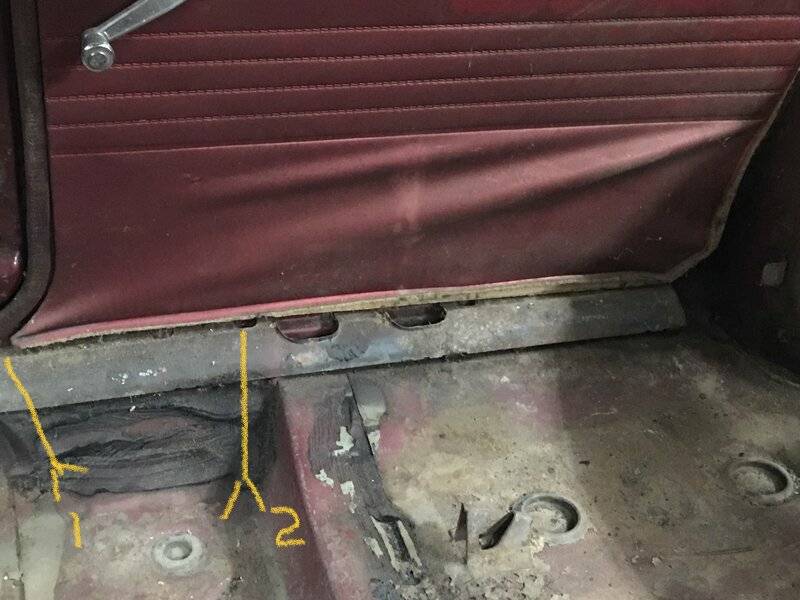

OK peeps, having some difficulty figuring what I need for the rear door card (2 door) for my 67 Coronet. Is there a piece of trim at the bottom? In the attached pic there’s an indentation in the panel that indicates that may be the case. I bought new panels for my 500 which didn’t have any door cards when I bought it. Trying to install new ones and trying to figure out if I need to cut the carpet (to be covered by trim of which I have no idea what it looks like) or tuck it behind the card. My R/T is in the pic below...I figured it would probably be the same. I bought

Let’s call them rear interior panels. The carpet does not go underneath, it just goes right up to it.

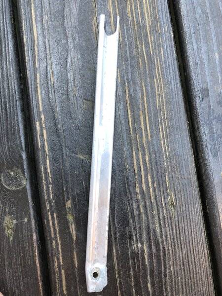

There is a thin aluminum trim piece. It’s held on with 2 long screws that go in at a 45 degree angle. The front hole is through the sill plate. The thin trim goes under the sill plate. Round hole to rear, slot to front. They are different R and L.
Yeah...mine definitely bent on one end, we’ll see if I can straighten out. If not, I’ll be in the market for a pair of em. Thanks.
