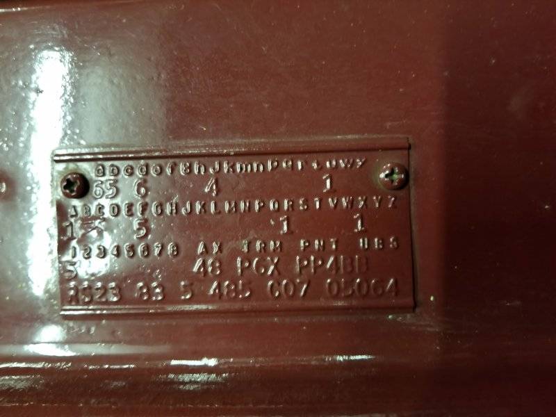

Every 67 I have or have had were painted body color. Also they usually show signs of being bent by one of the screws and the other screw is unpainted.

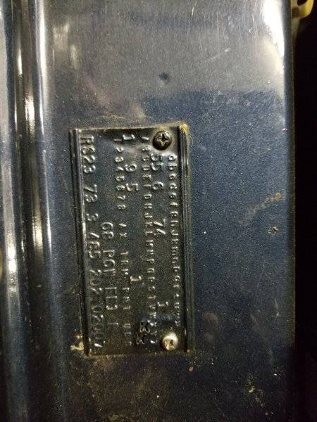

Lynch Road cars Jerry?
I'm sure some of them are. Most of mine were originally from the east coast or thereabouts. I have only had one 67, that the fender tag was not bent at the upper left corner, indicating that they were painted while bent up. The bare screw is in the upper right when standing on the left side looking into the engine compartment.

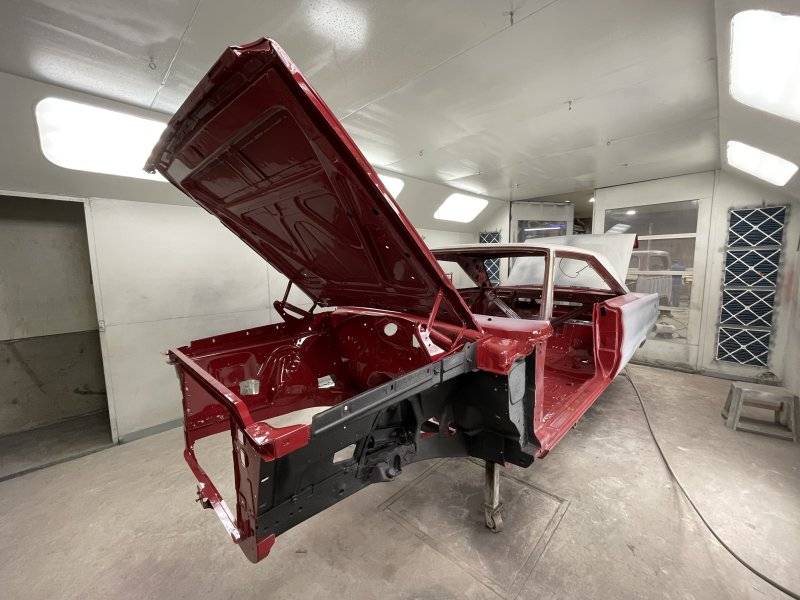

Here is a Lynch Road car.
It's been repainted, the reason both screws are painted.
