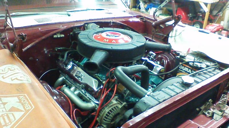

Well, just got done breaking in new Comp cam. Had an issue getting the motor to prime yesterday. Did some research on the site, thought I would start with the easiest today. Got rid of the fram oil filter, put a Napa gold, filled it with oil, reprimed and finally had oil pressure. Love the Pertronix 3.
