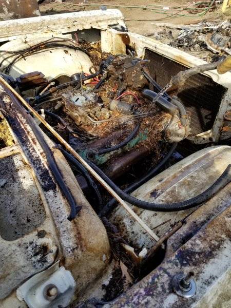

The engine came from a C-body - no 335 hp cam ever came in those cars.
And the AC would've relegated it to 330hp in B-E body anyway.
The driverside HP manifold will not be correct for B-E body, but maybe it fits anyway? The rear-dump B-E HP manifold seems to fit some C-body installations.

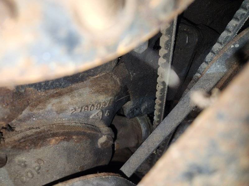

That's why I was saying it may have HP parts but not actually stamped as a HP motor. So technically it is a '68 383HP but not on paper or stamped as one.
