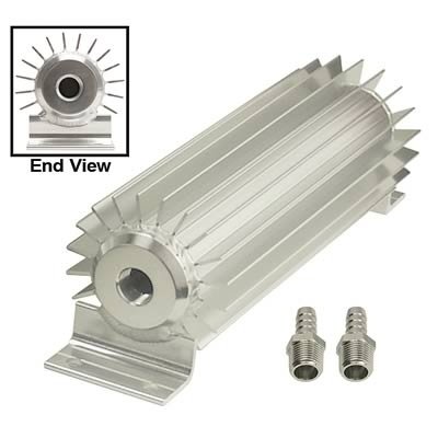

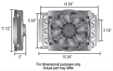

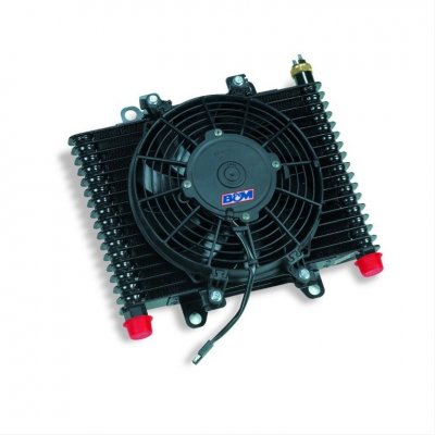

I always had a "heat sink" inline on the out "pressure side" &
a really good trans cooler "with a fan" on it for the "suction side",
so it always had cool appr. type of fluid...
