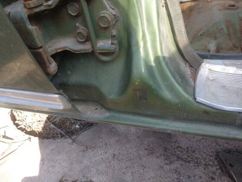

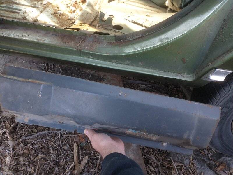

The 2 door rockers are differently contoured behind the quarter panel. The four doors have the same shape front to rear. Also the 4 door rocker is different where the center pillar between the 2 doors meets the rocker. Both of those would have to be addressed
In looking at a picture of a 4 door satellite and a picture of an after market 2 door outer rocker I can see exactly what you are talking about. The bottom line is that I would also need either a portion of a 2 door outer rocker or a complete 2 door outer rocker.
Thank you again.
Ron
Here is the center divider. Only the top of the rocker is affected by this. The contour is different to accommodate the pillar.
