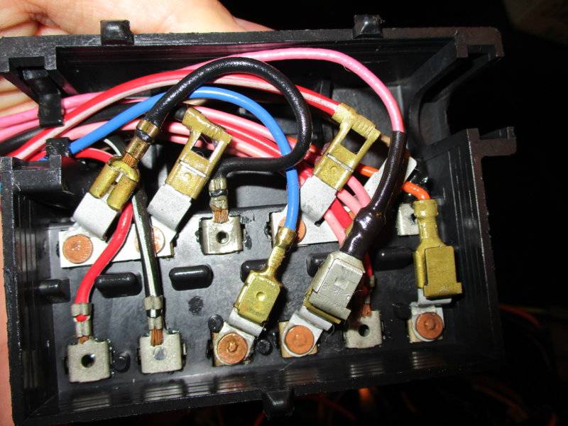

I would start there......The dash harness is the same for all cars but the tach harness is an additional harness you can purchase....
Just make sure you have the tach wire to the fuse block on the right one.....ck the service manual
In the pic it is the blue wire......
That's exactly how I have it hooked up. Could the gauge be grounding somewhere and throwing off the coil?

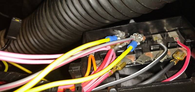

This is what my fuse panel looks like. The grey wire is for the tach along with an aftermarket radio.

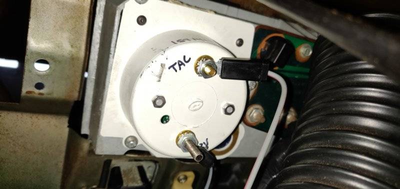

Do you have pictures of the tach, especially the back?
Here are pics from the front and back. The needle is up because the speaker magnet is close. I have to shield that somehow.

You may want to see if the phonelic washers on the studs are cracked and shorting.
I used rubber grommets to insulate the studs.
