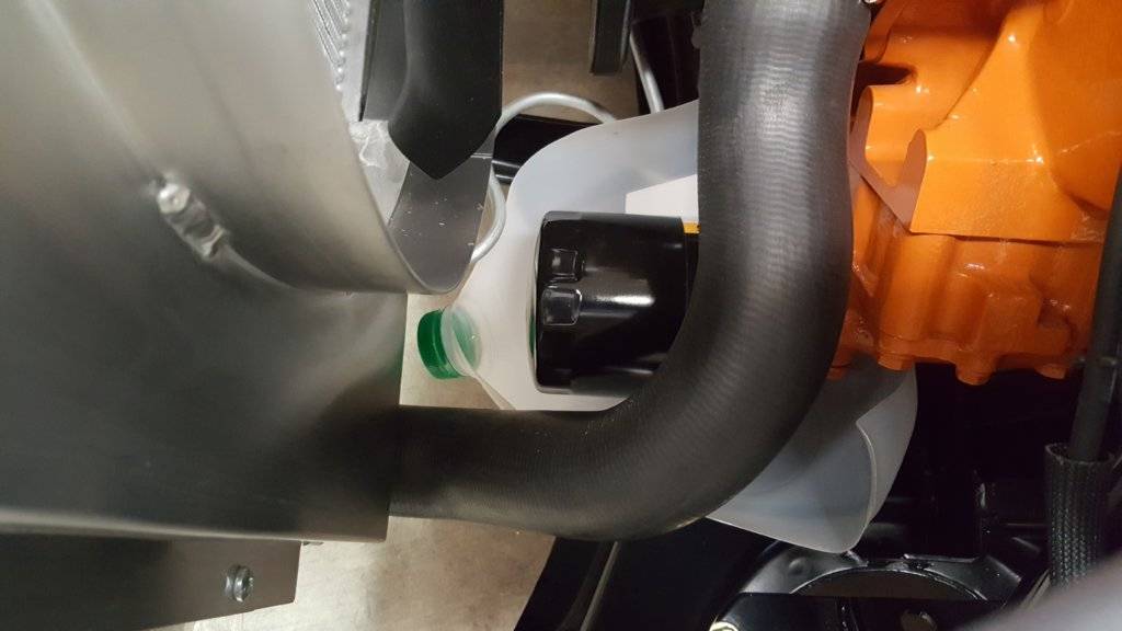

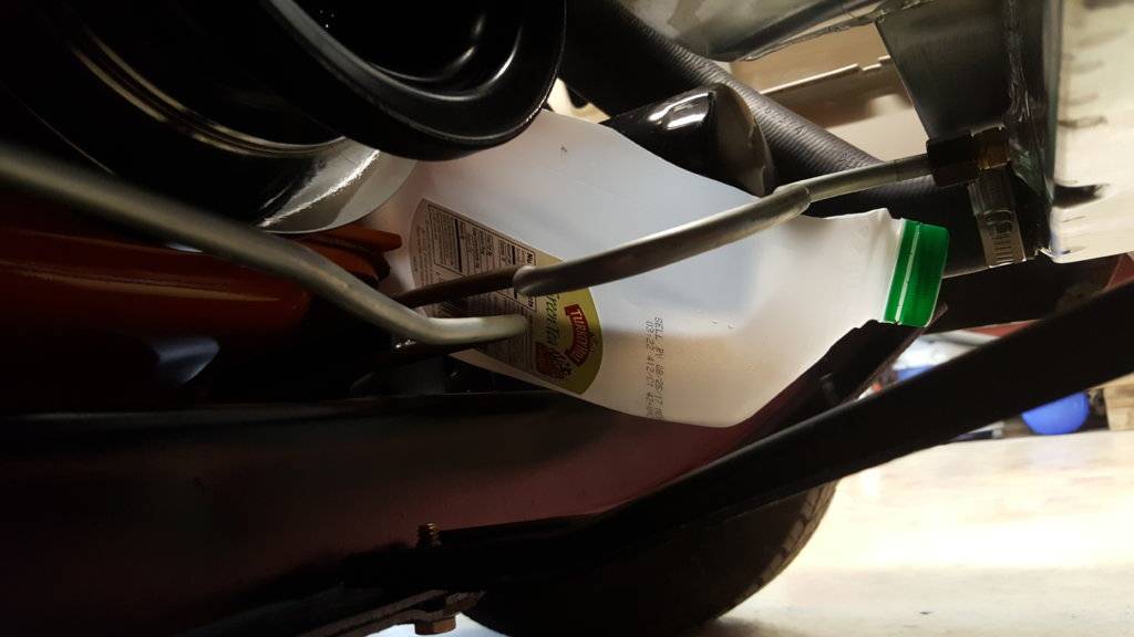

Mine drops out the bottom. Aux trans cooler lines prevent it from exiting the top.
Mine drops out the bottom. Made myself a catch can out of a gallon jug. Take a razor and cut one in half.
