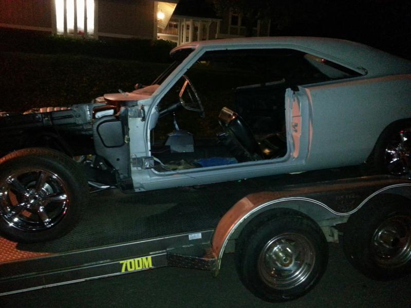

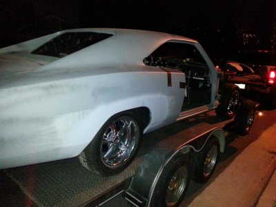

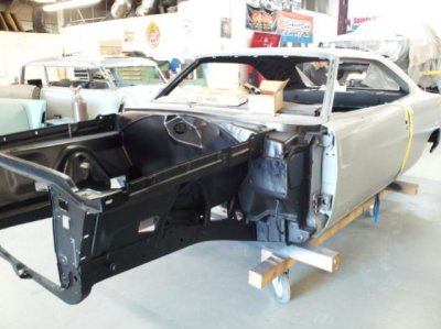

CHARGER finally off to paint..
Going to be Stryker Pearl Red (2013 Viper)

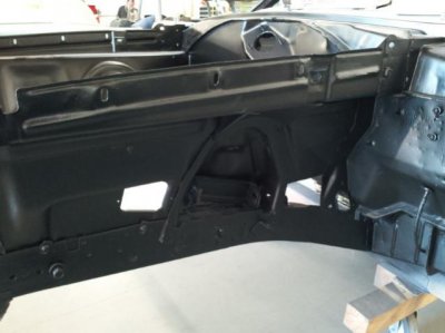

I went with Satin black under the hood, and undercoated the car and interior, this will be a daily driver for me....
I love the rendering .I just wish that the ALTERKATION subframe makes the front wheels stick out so you cannot put on deep dish rims.........

I also can't wait, it has been sitting at paint and body shop since Thanksgiving.

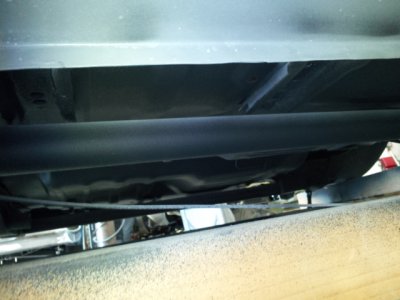

Hey Goose,

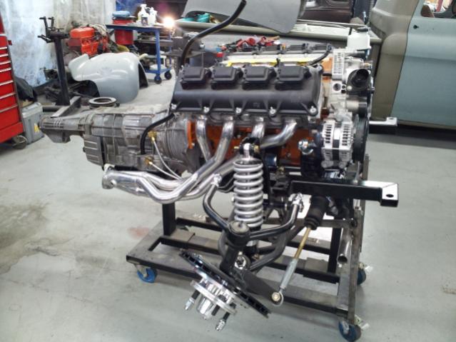

Got any pictures of the tunnel and crossmember re-fab? I plan a similar install with a 6.1 in a 68 Charger. I'm interested in any leadership you have

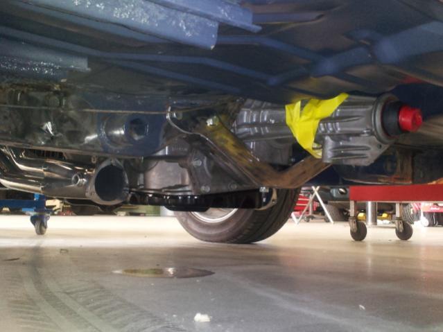

I hope the pic uploaded, didn't have to do really anything to the tunnel, just a few taps with the hammer, the cross member was totally custom.

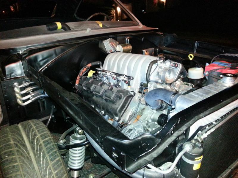

Looks Great! What are you doing for a shifter? I heard the tunnel needed lots of work to fit the 545 but not so huh? I would like to use my factory console and shifter. I want the interior to be as stock as possible. I plan on staying with the Torsion bars and K frame. Not planning any road course or race activity. Just want a 68 Charger that will start like a new one, run on the junk gas and get decent mileage on the road. I got real sick of having to get on the net and plan my trip according to where I could find Premium gas without ethanol. That is the reason my 6 pack Challenger is in Australia now. Also it will be interesting to know how you get along with the 545 transmission. I have heard rumors that it won't stand up to the 6.1.
Did you add any support for the absence of torsions bars and the extra force of the coil overs ? Most people use inner and outer fender support tubing to help with front torsional stresses on the frame. XV has a kit that includes engine compartment triangulation brace, lower core support and outer fender support. I also used welded in sub frame connectors. My ride is a rag top with a 440 and a 5 speed. I didn't want to take any chances on lack of strength... and body flex. What a difference it makes in handling. Sucker corners like a go kart.

Dude, I have a steel hard on after seeing that rendering. I couldn't pee to save my life. Wow. Why not go 6-speed? With the 545rfe trans, I assume that you got that unit from a Ram? Personally, I don't like cruiser muscle cars. I want a street beast and to me rowing your own gears is all part of that. But that's just my opinion. As far as the interior, you can get better hold from Recaros than you will if you go SRT. They are fine to cruise with but if you plan on really driving it then Recaro would be your best bet.
I am using the Classic B&M shifter,not too happy with choice, but I needed something quick for a 5 speed auto and had this one in my garage, might change later. the K member and torsion bars will be fine for cruising, I would take a look at Hotchkis TVS , FYI you can have the engine heads rebuilt to run on pump gas, I have done that with all my restomods, a lot easier than replacing with new motor
I have only subframe connectors, the AlterKtion saw bar will make a difference as well as the reduced weight of the aluminum engine, but I am using this as a cruiser mostly, this is supposed to be a project for me and my dad to do a long cruise before we both get too old.2011-12-07 15.18.35.jpg2011-12-07 15.18.49.jpg2011-12-07 15.20.05.jpg2011-12-07 15.32.41.jpg
