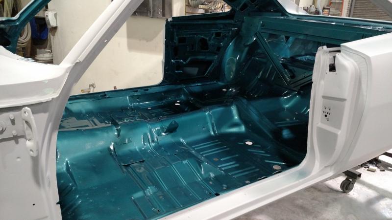

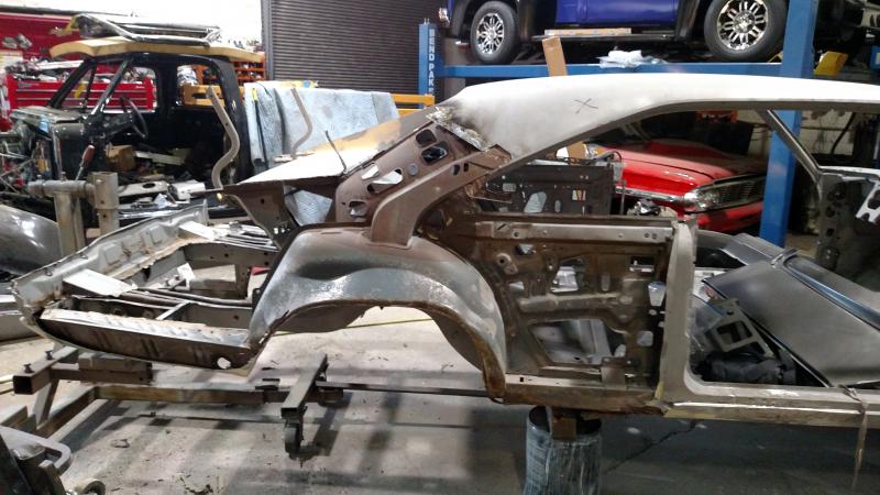

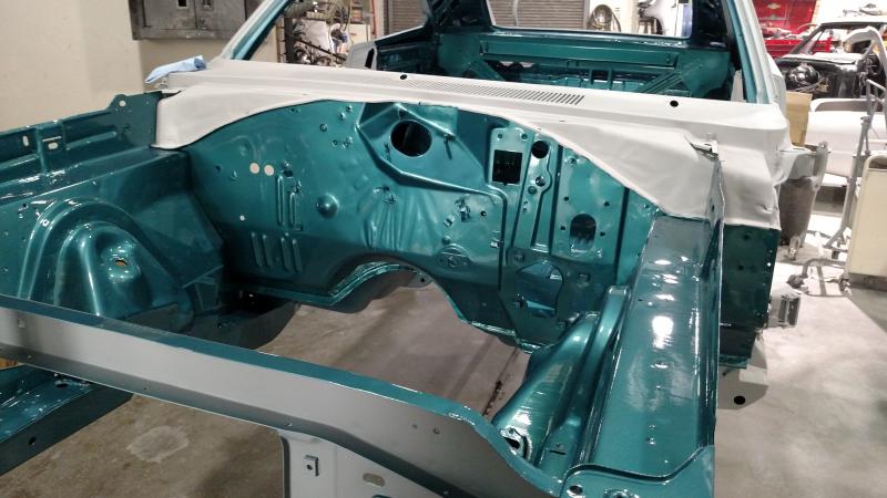

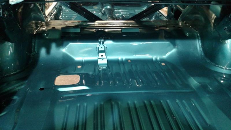

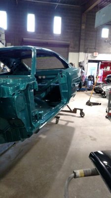

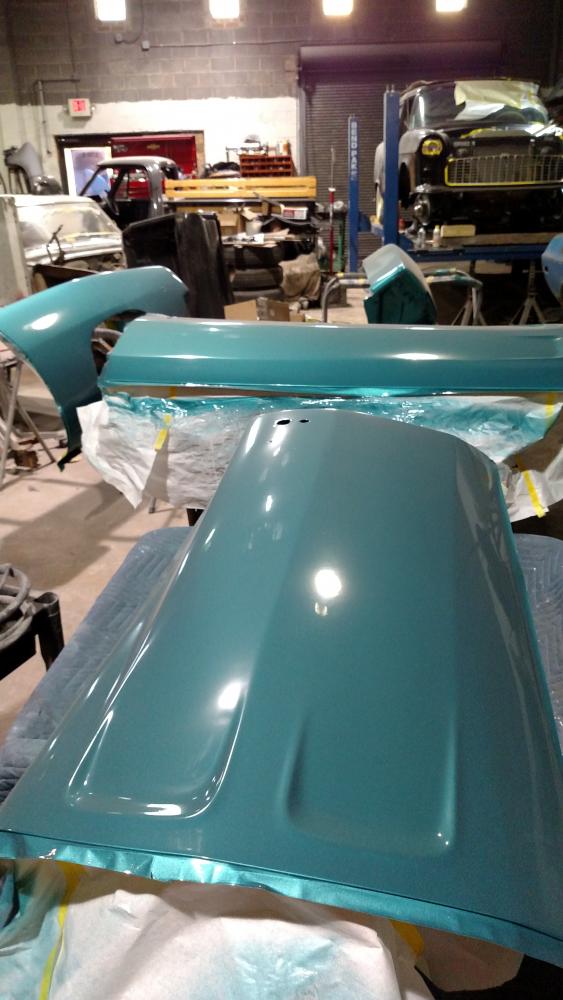

After a year of making mistakes, the car is finally in paint. Looking forward to finishing this stage. IMG_20151020_175049324.jpgIMG_20160108_155001178.jpgIMG_20160108_155033919.jpg
IMG_20151020_175049324.jpg IMG_20160108_155001178.jpg IMG_20160108_155033919.jpg
Members, Finished the main body. I hope to finish the hinges, battery box and bolts tomorrow. If things work out I will also paint

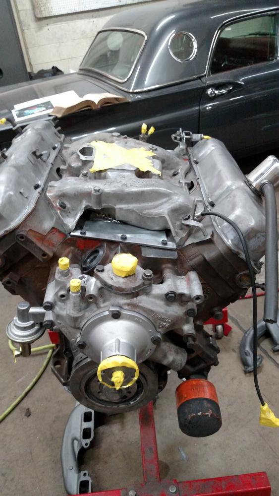

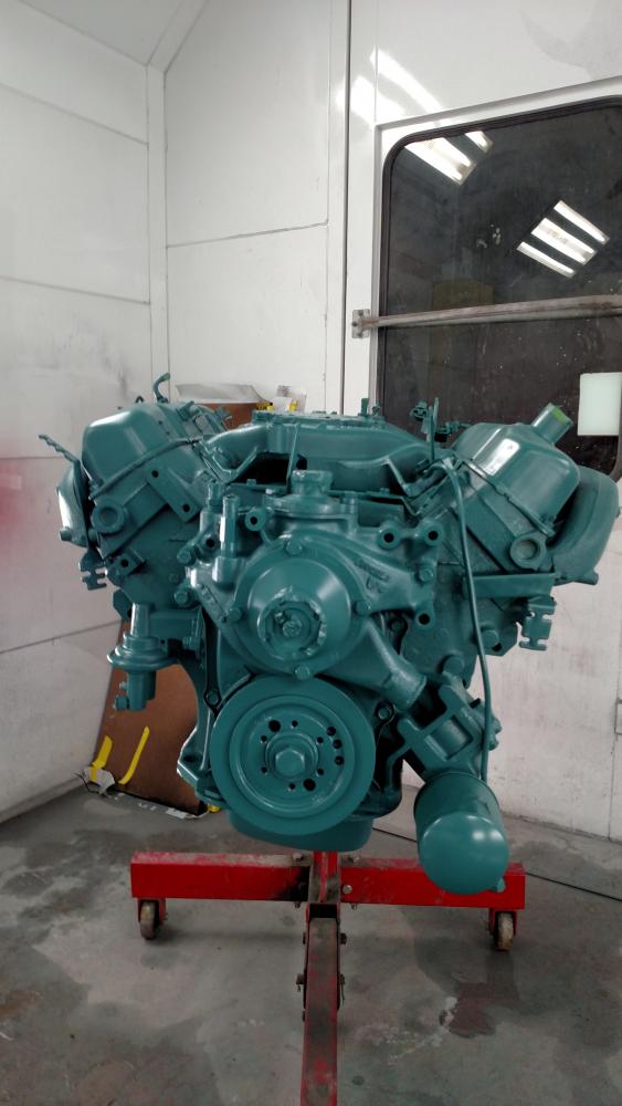

engine. IMG_20160108_155010873.jpgIMG_20160118_165438865.jpgIMG_20151230_122644152.jpg

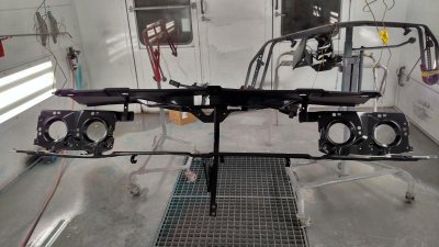

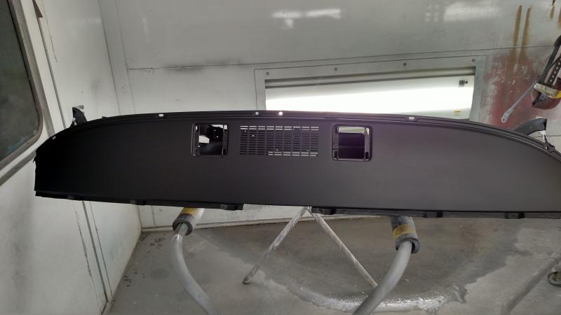

Painted the Engine - Roger Gibson's Engine Paint
Grille/Core Support - DP90 and DCC9355

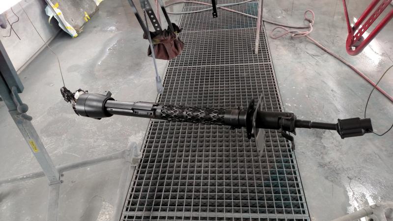

Dash and Steering Column - DP90 and OEM Suede Lacquer Paint. After painting the DP90, I IMG_20160120_175132346.jpgIMG_20160120_175221437_HDR.jpgIMG_20160120_175232729_HDR.jpgIMG_20160120_175241305.jpgneed to wait 5 days before applying Lacquer.
Still have to paint the inner doors (Ditzler 9000 - Raven Black) and the Tail Panel (DP90 and Organisol)

Dash and Steering Column - DP90 and OEM Suede Lacquer Paint. After painting the DP90, I need to wait 5 days before applying Lacquer.
