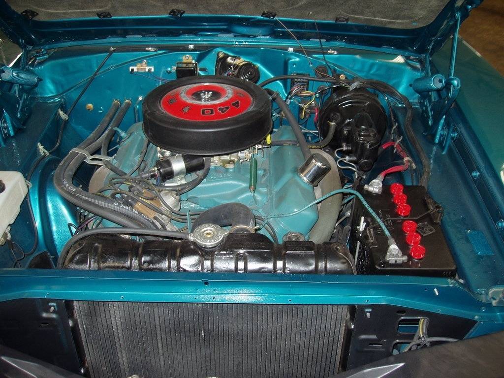

Members, We were going to start the motor and noticed no oil pressure on the oil gauge. No oil pressure – no start. So I went on line and purchased an oil priming rod from Summit to engage the oil pump. I marked the teeth on the distributor drive gear and cam gear where they meet, removed the cam gear and installed the rod. I attached the rod to a drill and going counter clock wise, primed the oil pump. So I thought things were looking up. We turned the motor over and it would not start. So after 30 minutes of four letter words, we figured out the carburetor was not getting fuel. So we pulled the fuel pump. It appears that the push rod had chipped the end of the fuel pump lever. I don’t know if this normal, but I went ahead and ordered a new fuel pump. We will see what happens this week.

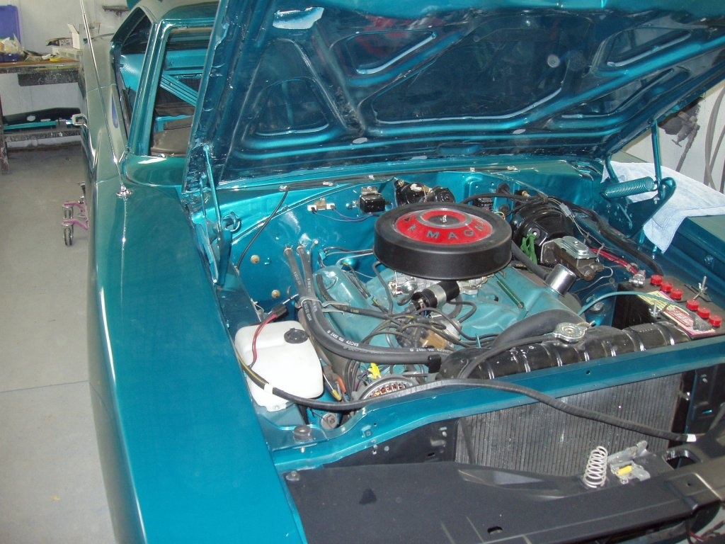

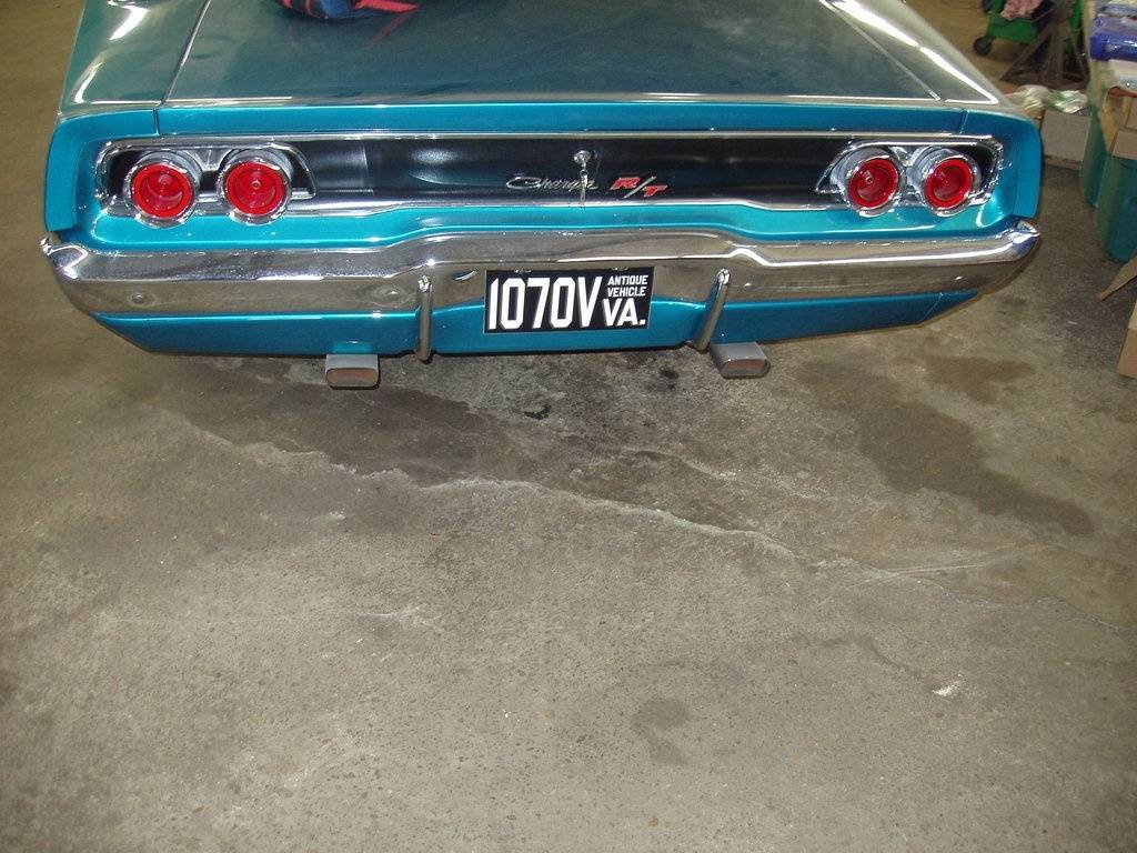

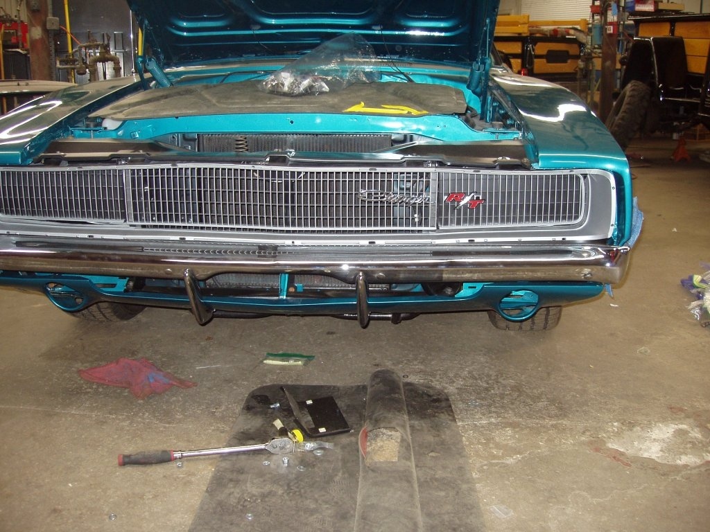

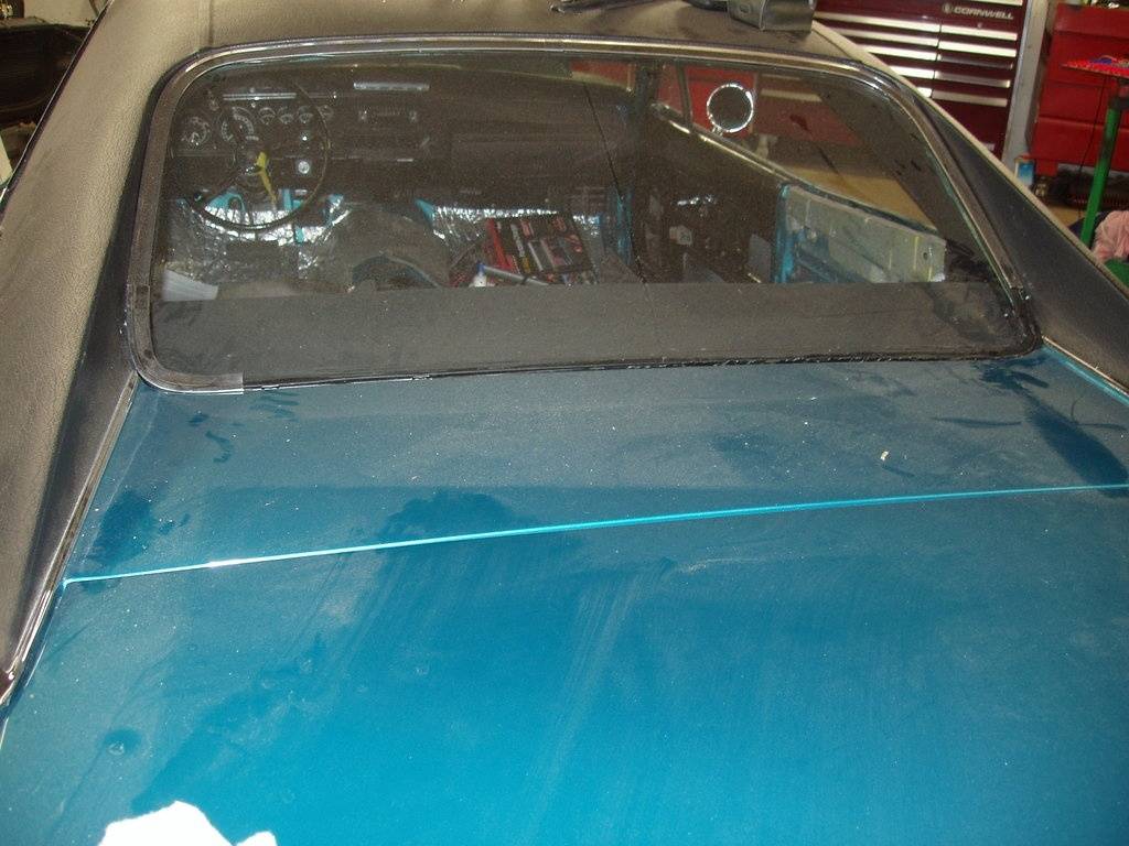

Members, slowly making progress. We got the grill, vinyl top, headliner and the quarter window regulators installed. The quarter window regulators were a bear. As you can tell the Charger emblem is off. We will have to modify. Next on the list: Power Brake Booster, Master Cylinder, and Turn Signal Indicators.

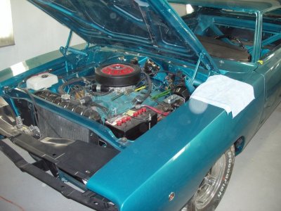

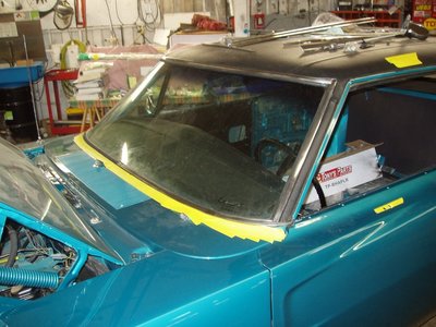

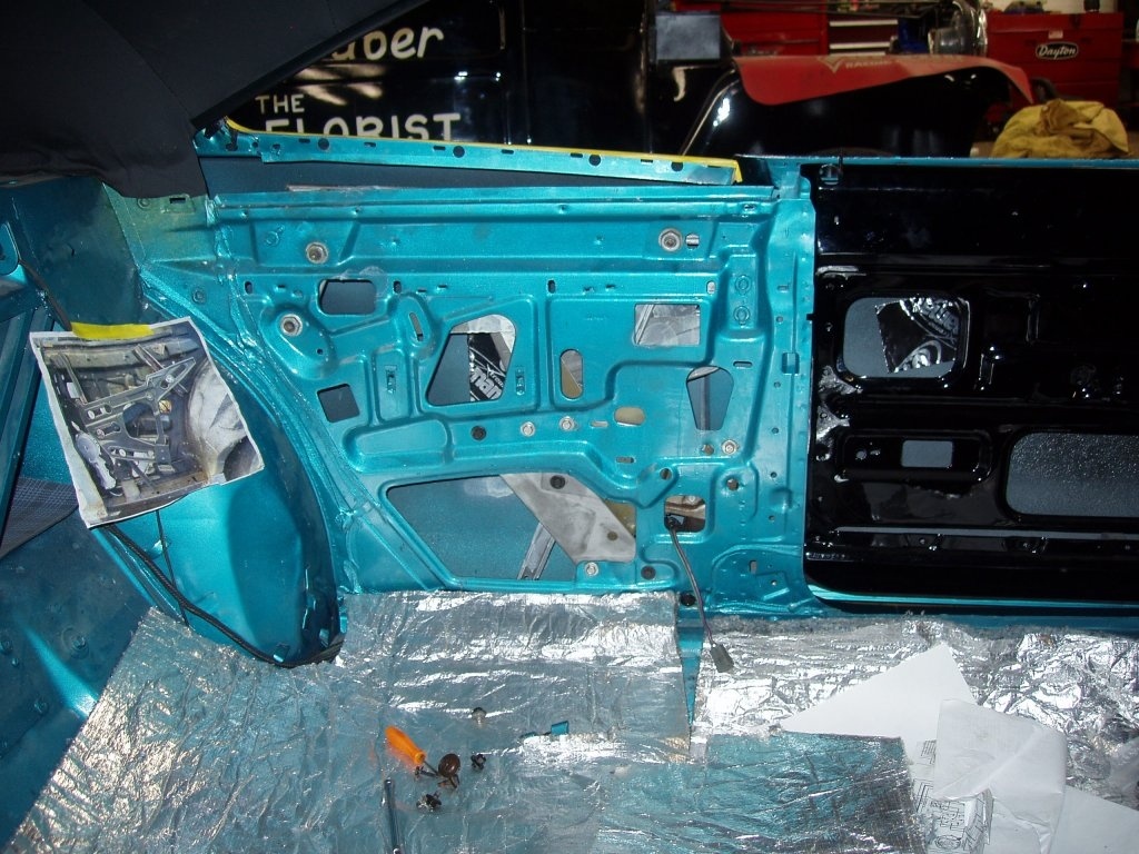

Members, slowly making progress. Installed the rebuilt brake booster, correct master cylinder, and turn signal signal indicators. Finally got the front and rear windshields in place. Next on the list: Door and quarter glass.

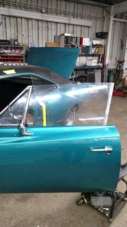

Members, After 10 hours of pain, we finally got the power windows installed. Next on the list is interior and molding. Hopefully, we can complete the restoration before Chrysler Carlisle. A special thanks to a guy in Tampa named Theodore Burtis. I call him Mopar Burt. He flew up and installed the power windows.

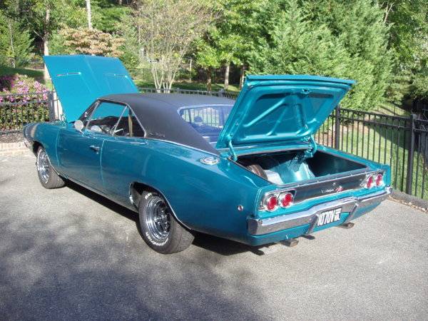

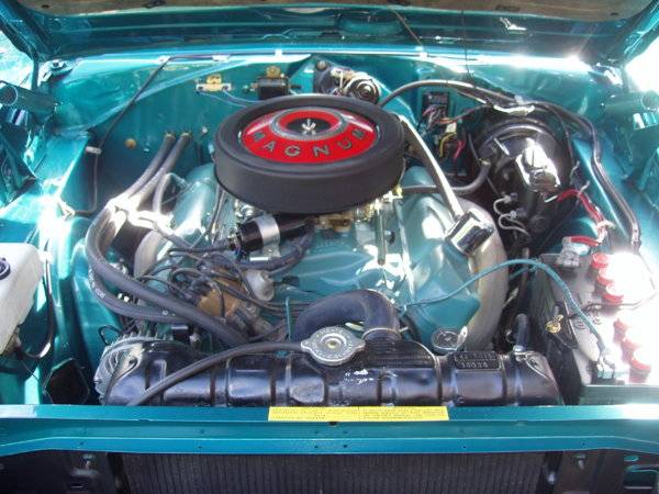

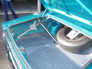

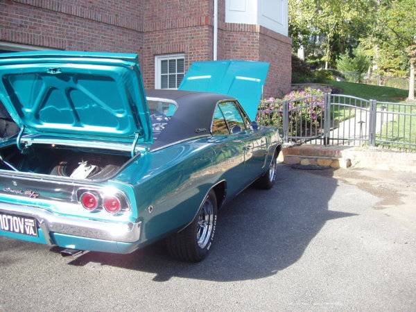

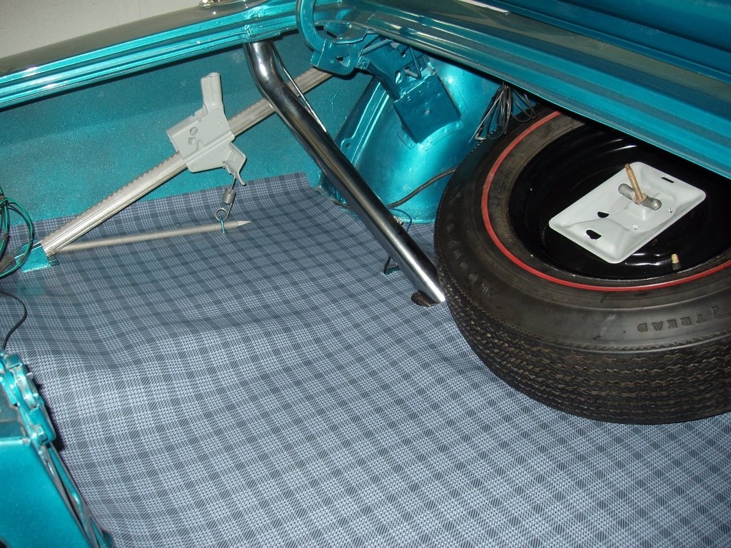

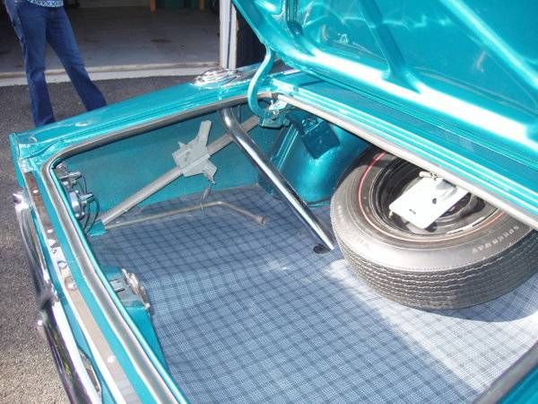

The car is nearly complete. I still have a few minor corrections to make. Thanks to all you guys for the advice during the three year process.
Scott
