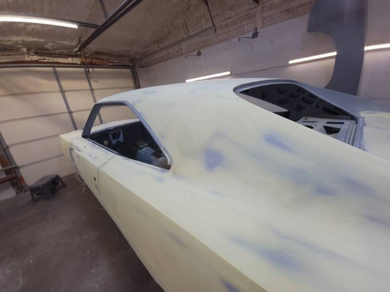

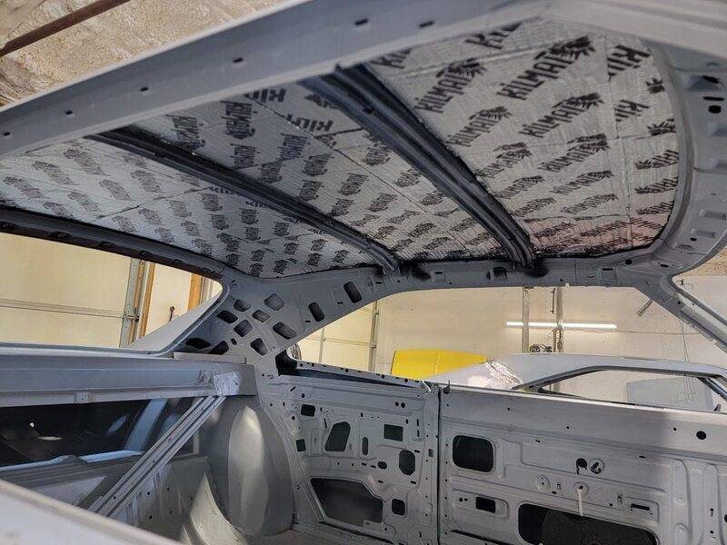

Roof ribs are glued to the roof skin. And the roof skins were covered with Kilmat.

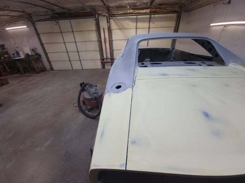

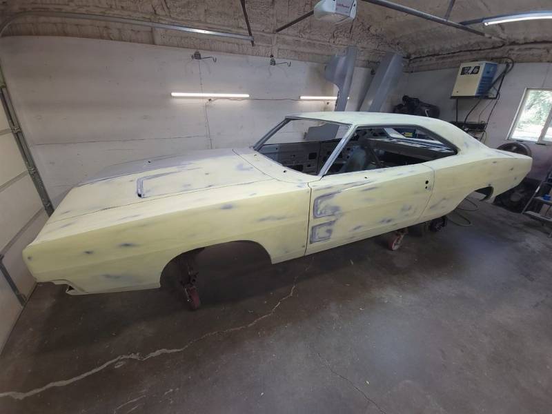

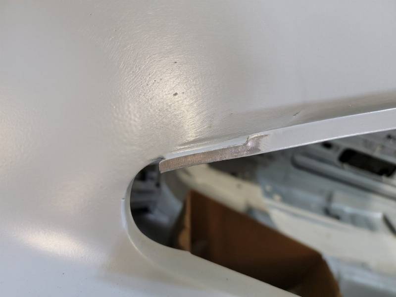

Been awhile...stuff has been happening at a slow but steady pace so I'll try to catch up on the progress posts. The trim along the tops of the doors was deleted so those holes were welded closed. Also patched one last spot in the door jamb at bottom of the passenger side A pillar

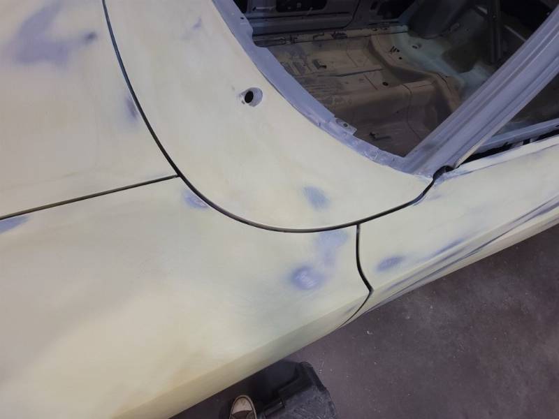

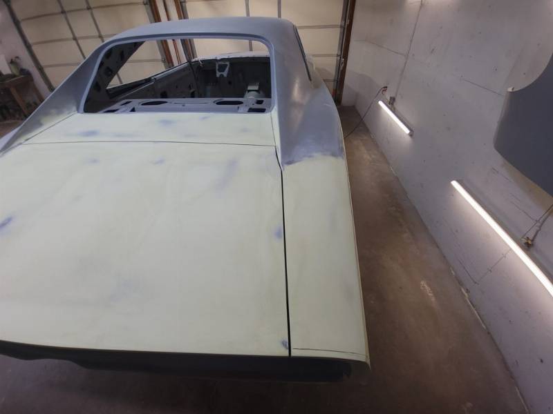

The gutter trim is also being eliminated. The gap at the top of the A pillar was filled in and the aft end of the gutter was extended slightly so water will not run into the bottom corner of the window.
