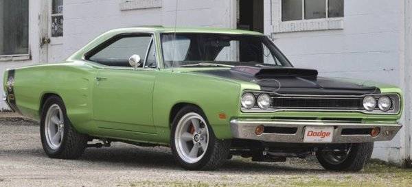

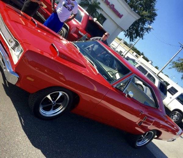

Here are a couple pictures I’ve found online of super bees running 17” Wheels. Looking into putting some American racing Vn501s in 17”x8” rear and 17”x7” fronts on my 69 superbee. Wondering if anyone else has any pics 17” Wheels on their B bodies for reference? Leaning towards nitto nt450 275 50 17 tires in the rear and Nitto nt450 225 50 17 for fronts. Does anyone have any expierience with these tires?
