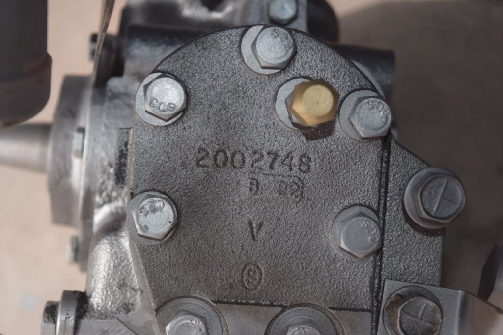

Spent most of the day at the hospital as my mother had emergency hernia surgery last night. She is doing fine. I did have enough time this morning to reseal the Saginaw power steering pump. These things are really easy as long as you not replacing the front bushing. The Gates kit I bought from Rock Auto did not include the bushing and I did not think I needed to based on the lack of noticeable play. Once I got it apart it was clear there was still minimal clearance and a new bushing was not needed.

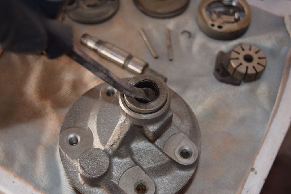

Once the tank is removed the clip is removed by putting something through the hole in the casting that pushes the clip out so you can start rotating it out of the groove.

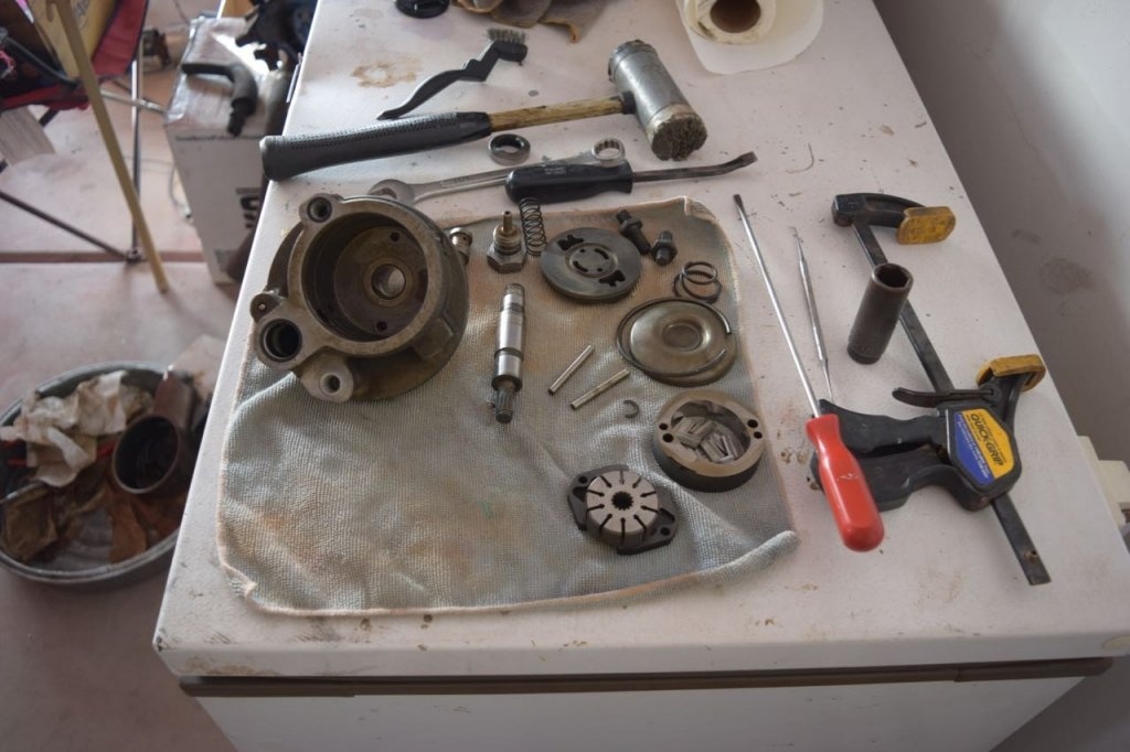

Once apart just pry the seal out. The shaft is removed out the back. I removed the C clip on the rotor and completely disassembled it. You don't have to do this (and the manual suggests you replace the clip with a new full round clip if you remove it). I was very careful removing and installing it and don't see where I deformed it at all so I am going with the original.

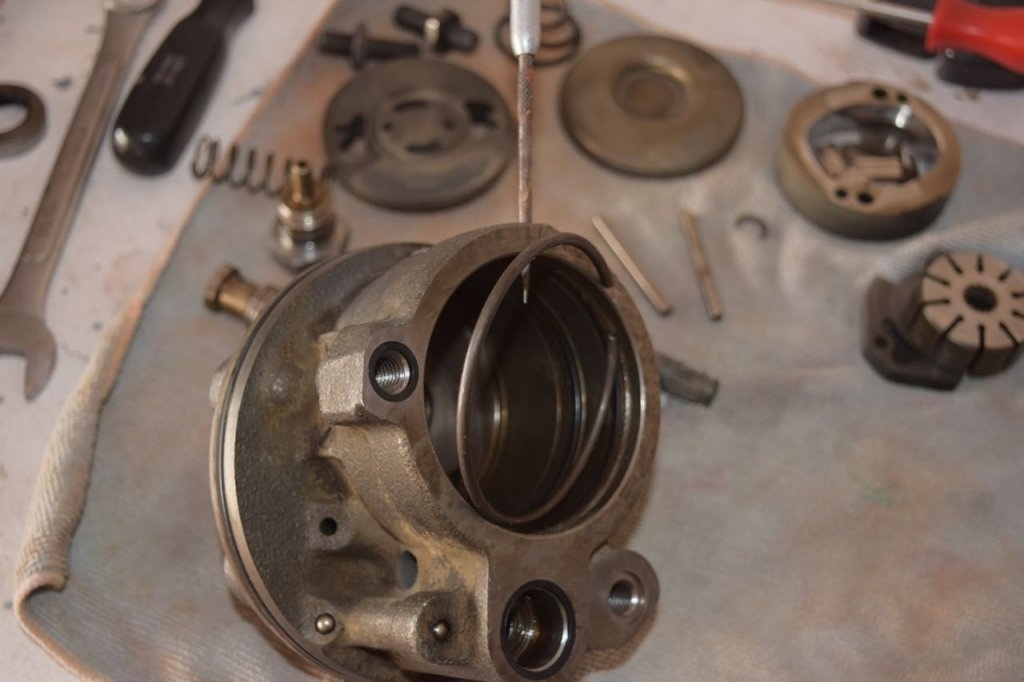

All cleaned up and ready for the new o-rings and reassembly.

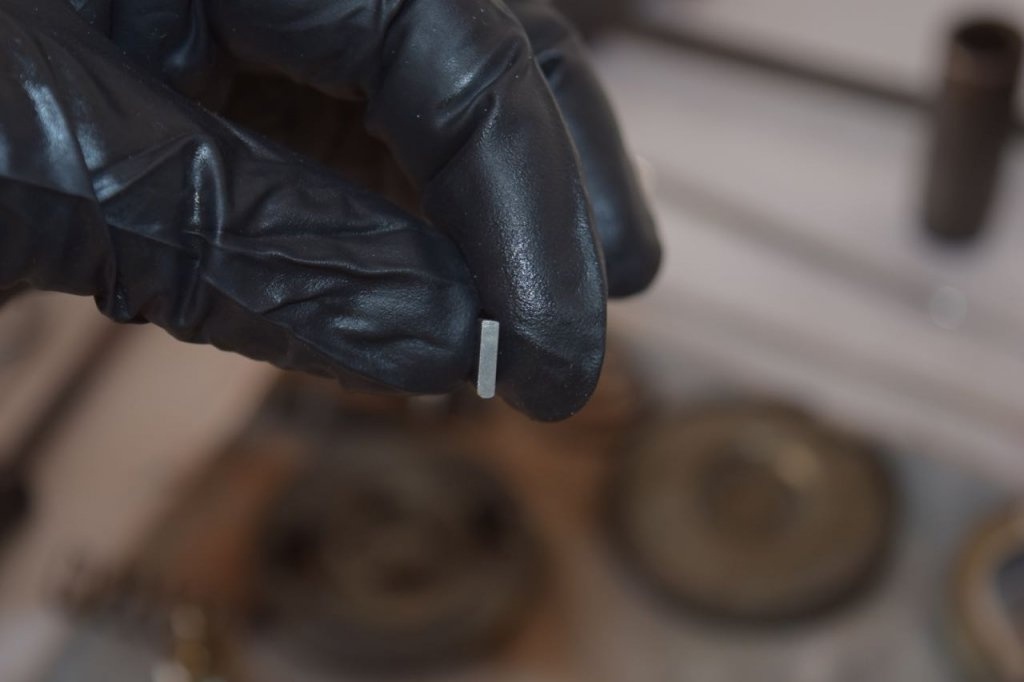

When reinstalling the vanes make sure the rounded edge is out.
The cam where the vanes ride on has an arrow on the side of it. That arrow much go "up" towards the tank. If it is placed in upside down the pump will need to rotate the opposite direction to develop pressure.

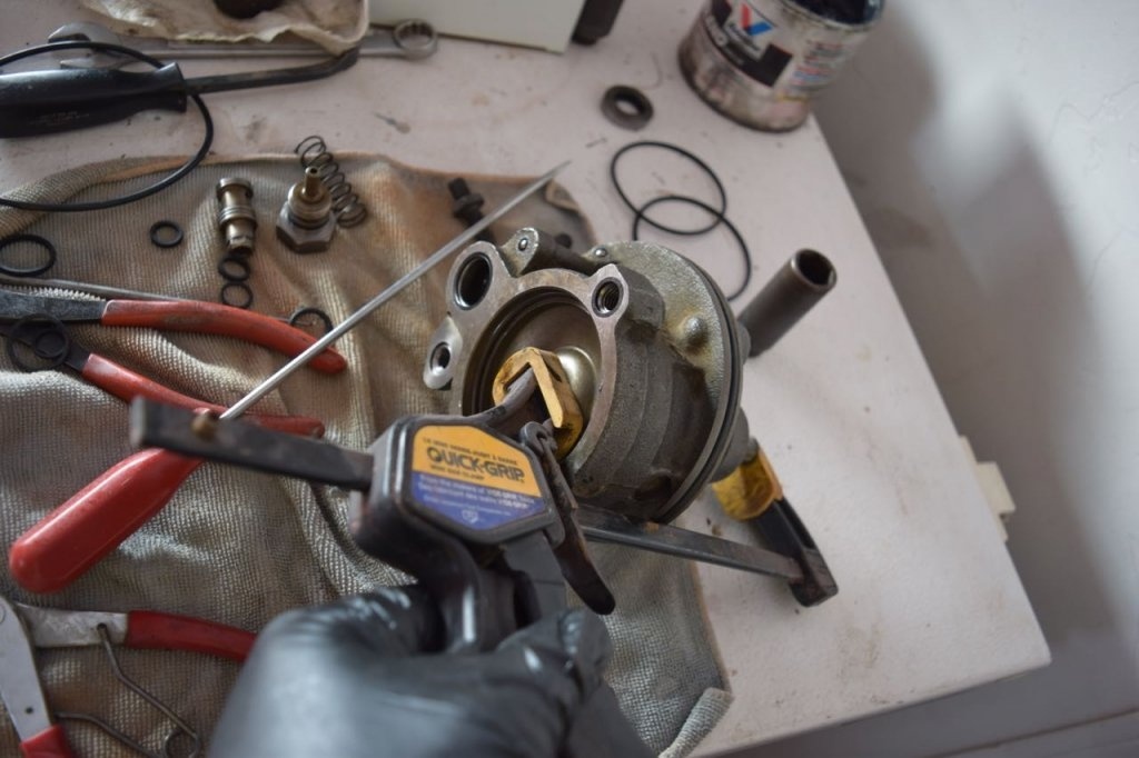

A simple clamp works great to compress the spring and cover to get the big clip back in the groove. Don't forget to lube all the o-rings before assembling.

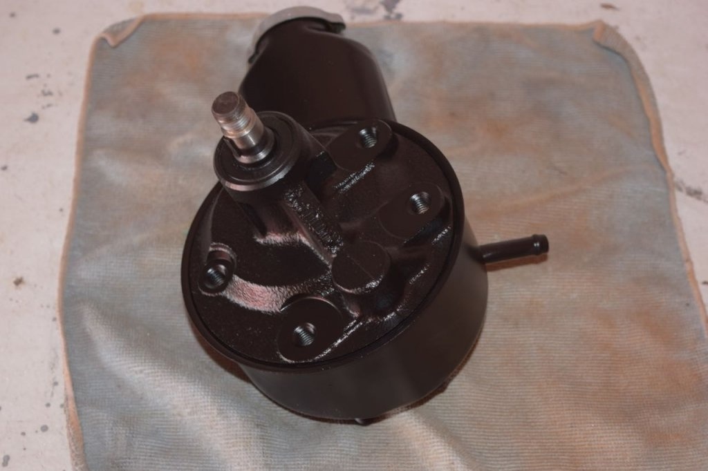

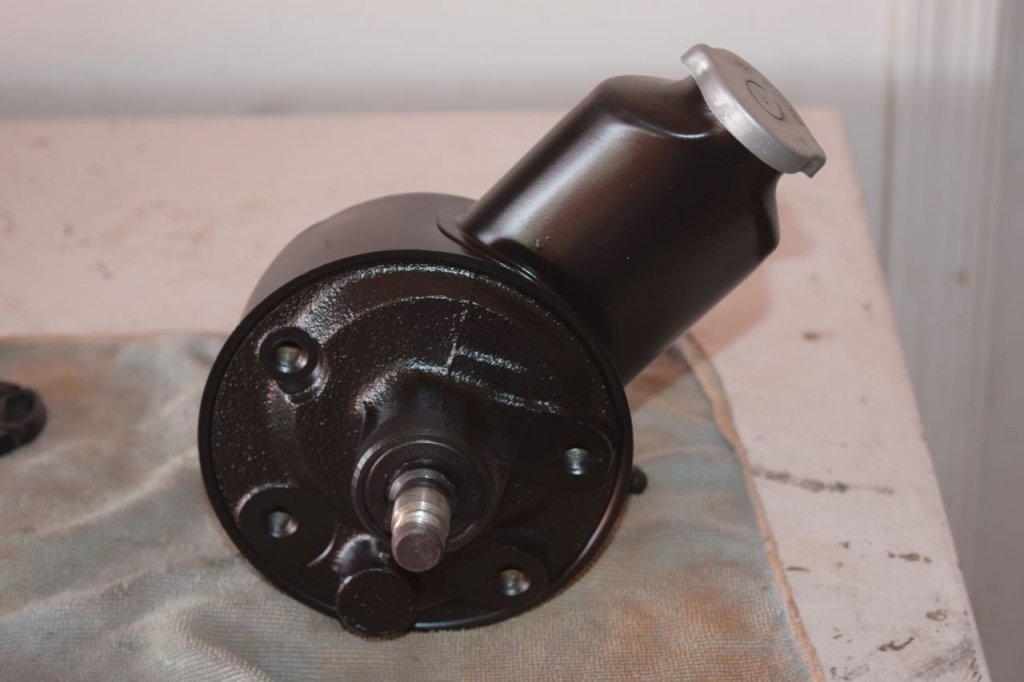

Final cleaning and a new paint job and it is ready to install.
Total time less than 90 minutes and less than $15 in parts.

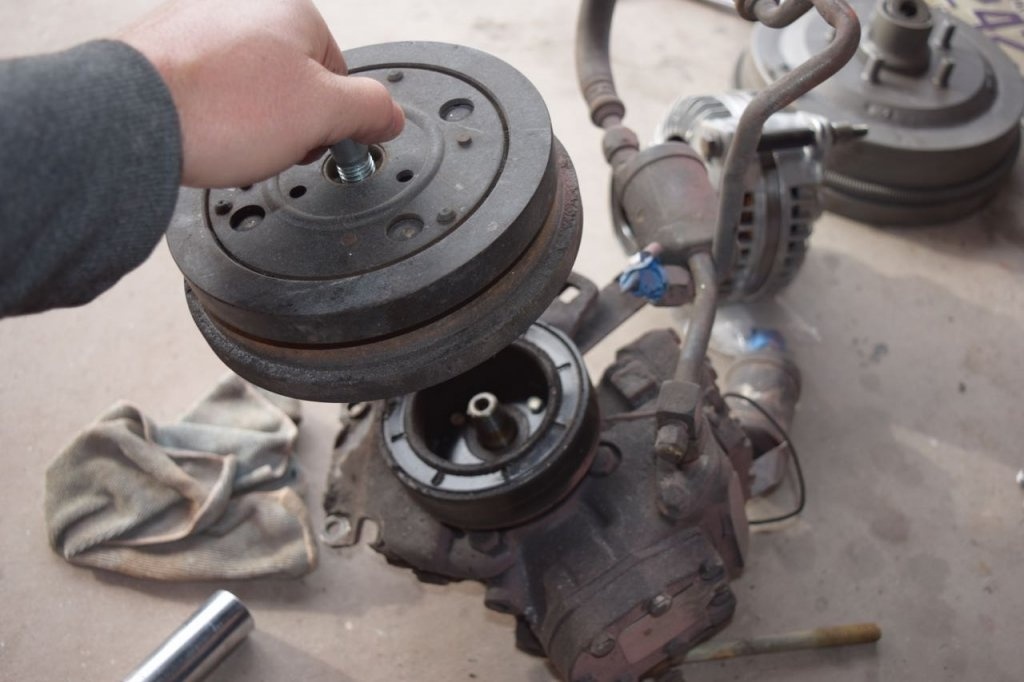

Started to assemble the accessories on the engine and come to find out that what I decided to not do right now is what I need... The alternator mounting is to the AC brackets... did not remember that... Time to restore the AC components...

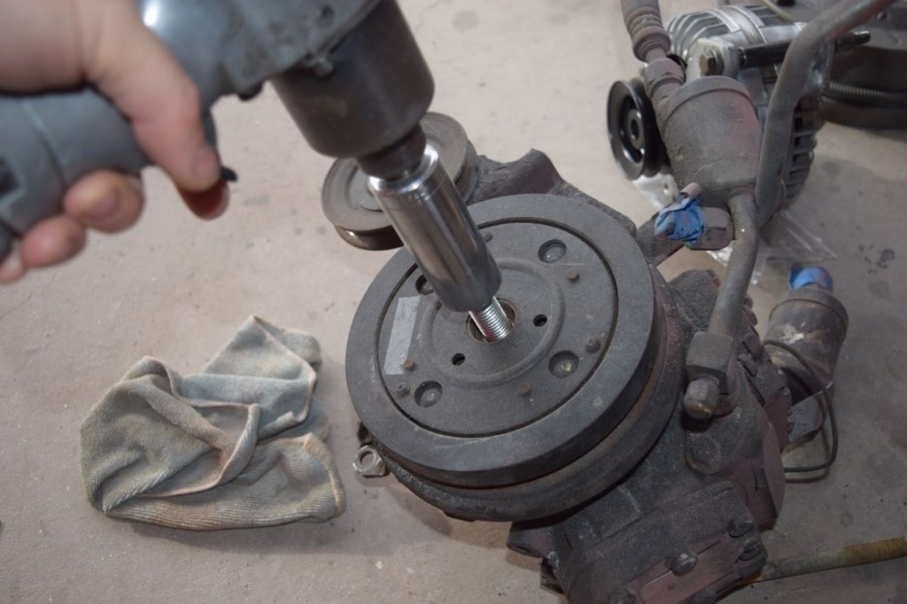

The Manual says to use a 5/8" 11 x 2.5" bolt to pull the AC clutch off. Worked like a charm with the impact

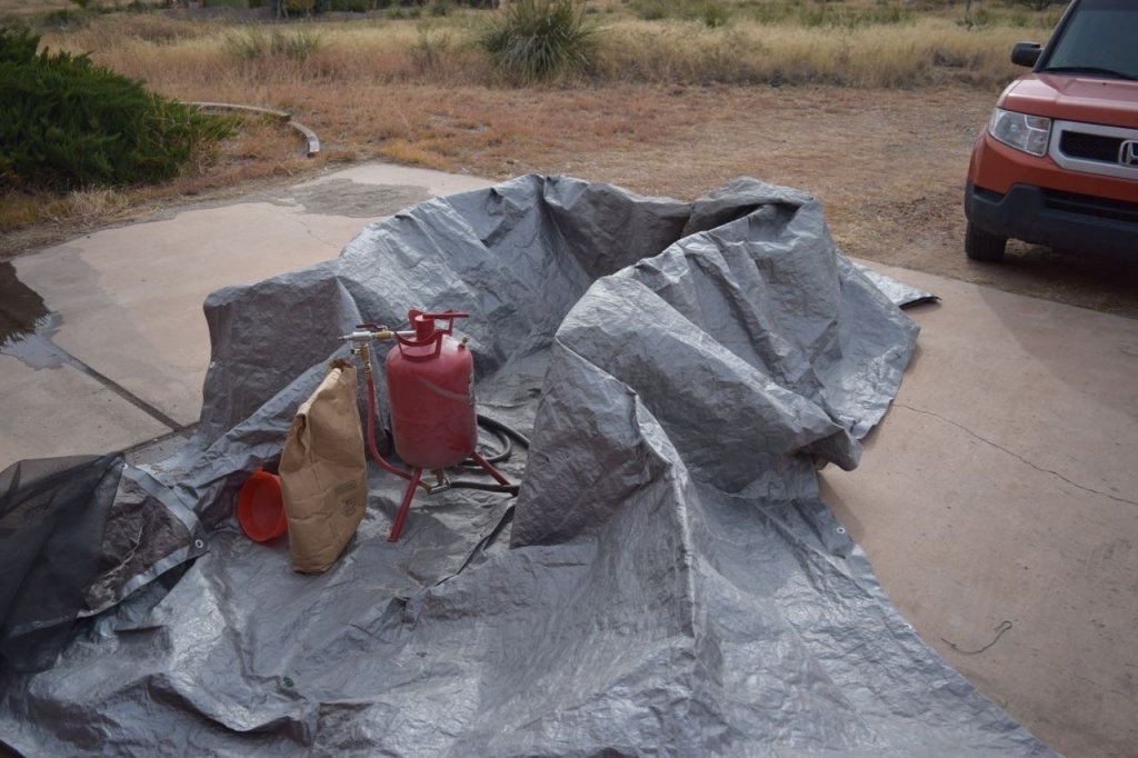

If I EVER do this kind of thing again I AM buying a nice bead blasting cabinet. This is getting old...

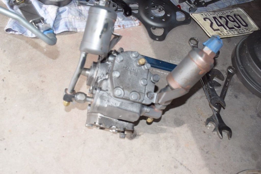

AC components are clean and like new.

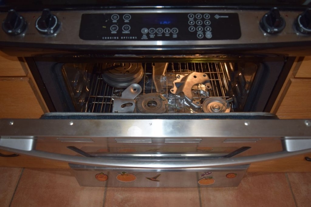

Well fall is finally here in Arizona. The temperature is in the high 50s so it is too cold to paint. Luckily the family is gone for the day so I can pretend I am cooking Thanksgiving dinner to preheat the parts before I paint them :). Please don't tell her...
My wife said jokingly this morning "won't his AC smell like turkey when he turns it on"?

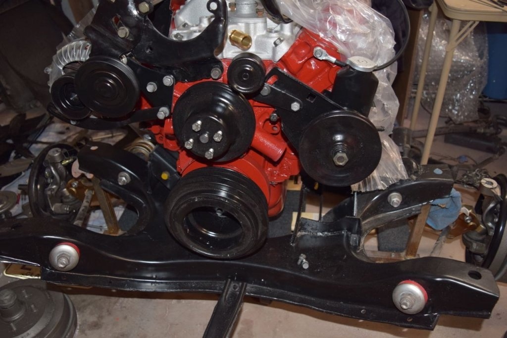

Spent several hours trying to relearn where all these stupid brackets go. I finally figured it out and seem to have one bolt missing. I am not sure if it was never there or not. Also a nut and washer on the AC was missing (from the day I got the car I am sure). I will need to raid Dave's Mopar bolt stash to see if I can find the right nut and washer :)
Notice all the finger prints all over the AC/Alt brackets. The Krylon is still soft..... The crank and water pump pulleys are SPI epoxy and tough.
