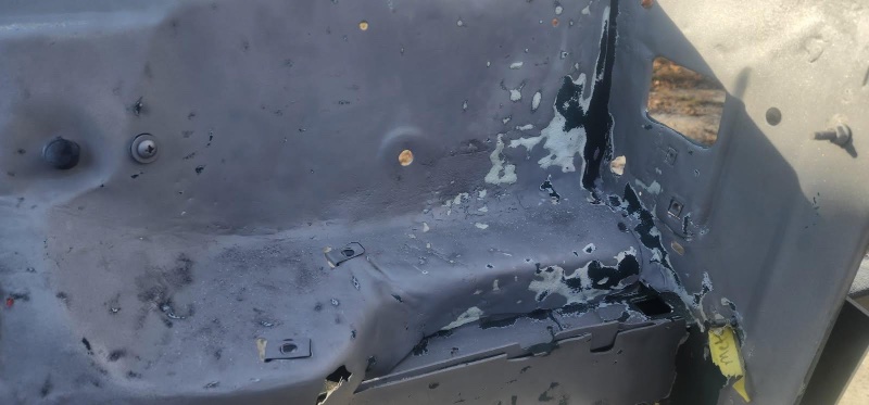

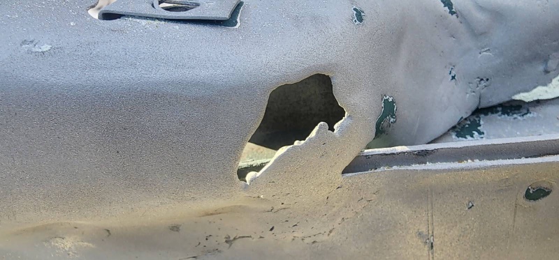

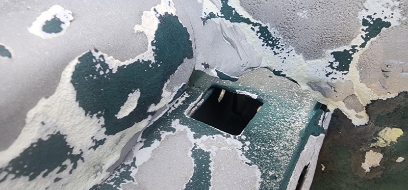

Going to narrow the frame rails to make room for the headers.

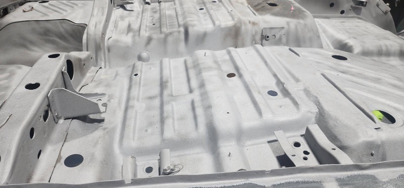

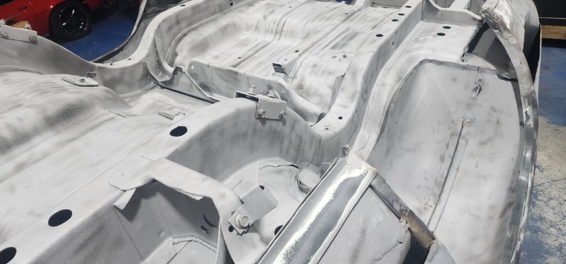

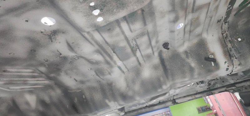

Did you find any more areas of concern?50 bags of glass media, or 2500lbs (2.25 tons), and the bottom stripped.
View attachment 1955244View attachment 1955245View attachment 1955246

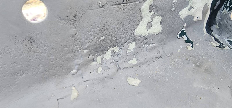

Nothing yet other than what I posted so far. Lower rear quarters, battery tray area, small area around rear window, one area on rear floor pan, and the rest is pin holes and minor spots. Nothing that can’t be fixed. My body guy is one hell of a metal worker/welder/fabricator. I wish they made fenders for this car. The fenders are not rusted but full of dimples. Like someone took a ball peen hammer to them. Hood is rough too like that. New fenders and a new hood and there would be almost no filler required.Did you find any more areas of concern?
Nice, I was thinking it would be worse than that underneath after seeing your initial posts. Your fenders were perplexing, hard to imagine why they got so bad, hopefully a few hours with a couple of hammers and dollies can improve them a lot. Glad to see it being done rightNothing yet other than what I posted so far. Lower rear quarters, battery tray area, small area around rear window, one area on rear floor pan, and the rest is pin holes and minor spots. Nothing that can’t be fixed. My body guy is one hell of a metal worker/welder/fabricator. I wish they made fenders for this car. The fenders are not rusted but full of dimples. Like someone took a ball peen hammer to them. Hood is rough too like that. New fenders and a new hood and there would be almost no filler required.
The one thing you can get for these cars is floor pans and trunk. I think they were all replaced during the previous resto. One of them was already starting to rust through because it wasn’t sealed properly. They also went crazy with seam sealer. Globbed that **** thick in the trunk and other areas. Took some time to scrap all that out and of course there was rust starting to form already underneath because of improper prep.Nice, I was thinking it would be worse than that underneath after seeing your initial posts.
I'm late to this thread, but no kidding. We dug into the driver's side quarter of the '74 Road Runner my dad and I have and there was so much rust. Ended up driving a quarter panel across country from here in AZ back to PA to repair it, and even that quarter needed some patches.How do all of the inner structures, rockers, frame rails and floors look. I would want to do a very thorough inspection to verify the car's "bones" look solid. All of the damage shown looks to be mainly superficial to the core of the car. Usually when they look like this there is a lot more damage, especially if the car came from the salty roads of a northern state. Any idea why the fenders were so dented up, they seemed to have a lot of unusual damage unless they were pretty crunched and tried to be crudely straightened before filling with way too much filler. Your car did look nice in the pictures for sure, sucks to see how they made it look that way.
