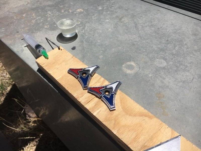

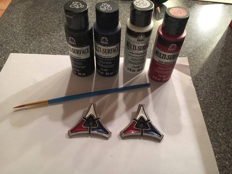

Found out these were suppose to have colored plastic insert which makes more sense. I through the grove around the edges was weird but that was where the plastic snapped in! There are no known reproductions so I improvised.
Acrylics in a close enough color for the first stage...
Then I mixed up some SPI Universal Clear Polyurethane and did a Pour....
Final result was HOLY FRAZTOG BATMAN!
