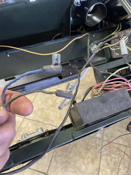

Wondering where these go. Thanks
They don’t look factory to me? Is that a splice in your hand they are joined into?

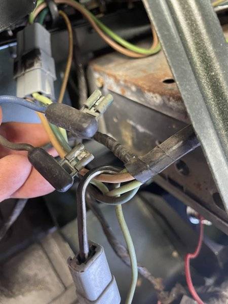

Not spliced. Factory. I’m holding them where they come out of the harness. It’s where the blower switch wires exit harness.
They look like some sort of add on harness. Where do the other ends of those wires go?
I have it looped around to where they exit the harness. Above green, tan blower wires
It is an AC car if that matters. I’m not seeing anything on diagram. Or I’m missing it
pnora is spot on. The ac box is already installed and its in the bottom of the box near the recirc door. Thanks a ton!
