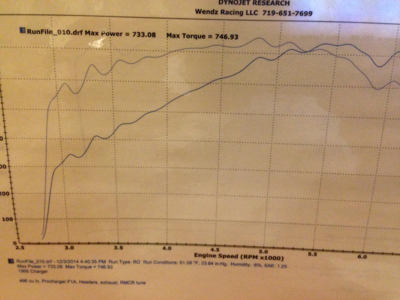

Hey guys,here is the charger on the dyno made 733hp and 746 torque to the wheels.
733 to the wheels YIKES !

Awesome !! I see the supercharger but cant tell what eng. We would love to know the specs on that beast ? Ron
X2 - please provide the details of your engine ! ! !

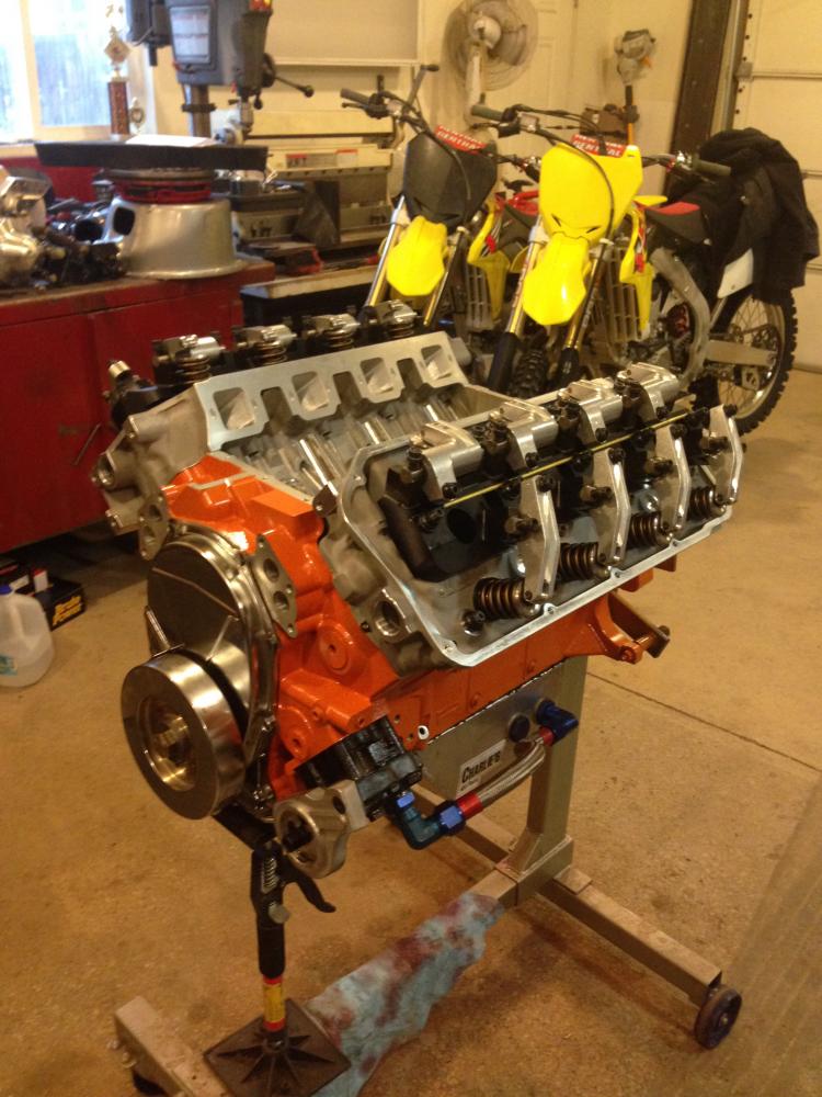

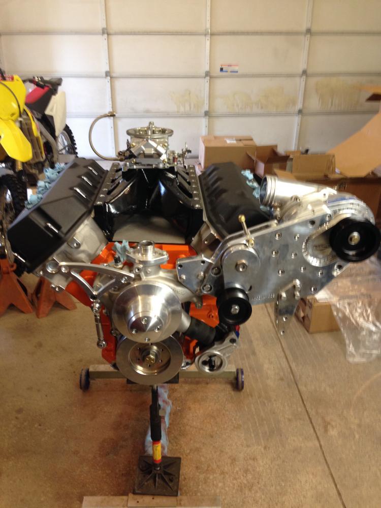

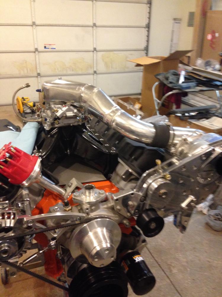

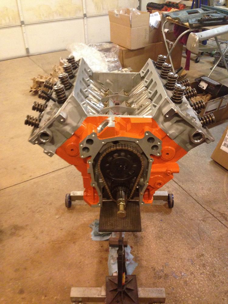

IMG_0148.jpgIMG_0143.jpgIMG_0139.jpgIMG_0132.jpgDSC01774.jpgThanks Guys, Sorry I forgot to put the engine specs. 496 cu.inch Hemi World aluminum block Stage V Heads,F1a Procharger it has a water/methanal injection kit.
Heres one of the cool things about this setup ( I Think). This was done on pump gas and it has a decent idle. I added some pics of when i was building the motor the pic of the 440 was the first motor I built for the car.
