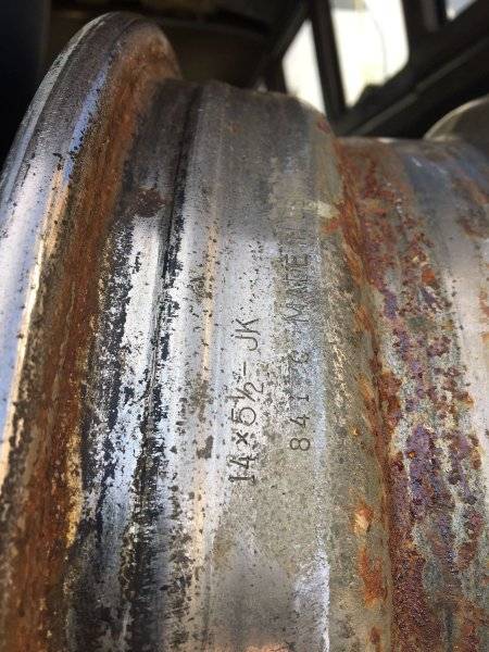

This is a original 14x5,5" Magnum 500 wheel

I think you are going right with edge to edge. But do you have original wheels? Or repro. If original it should be stamped inside. I do not think that 5.5" are reproduced.
