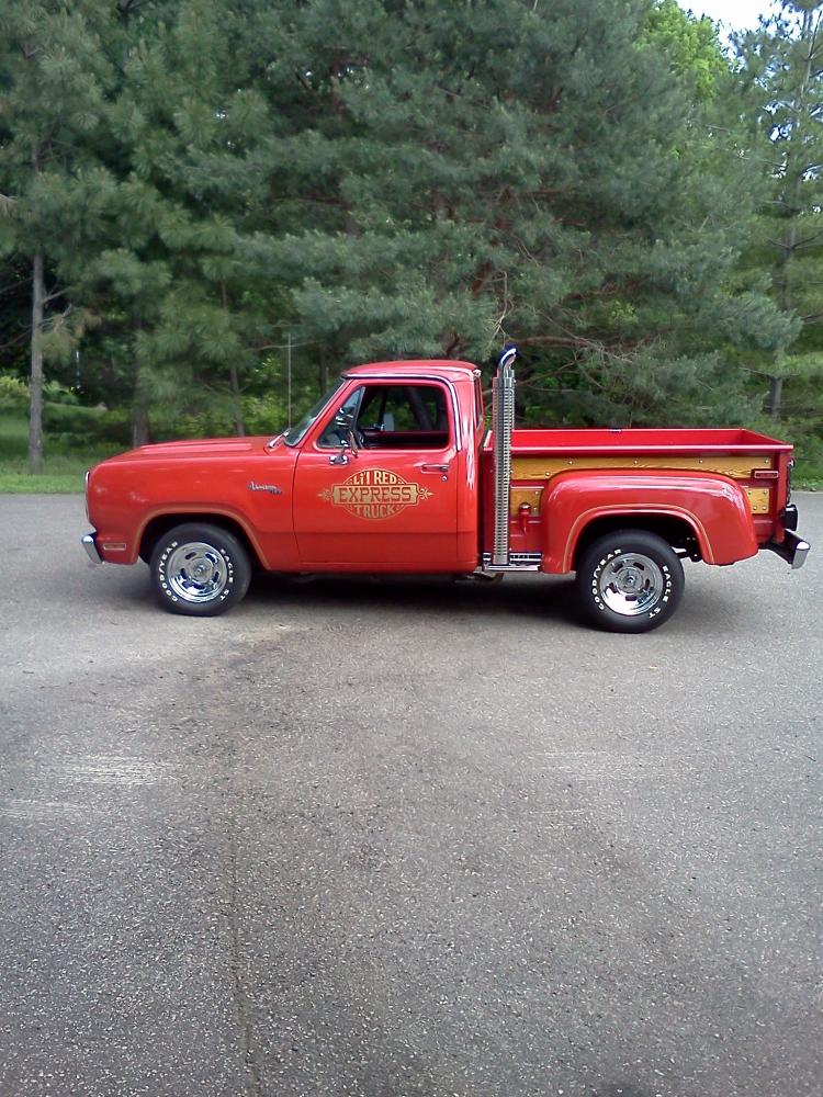

The Lil Red Express is a 55k survivor that my buddy is dialing in a few items for the owner. Very cool truck!

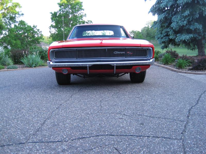

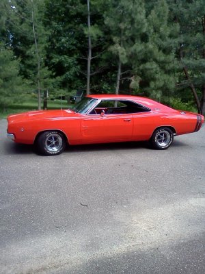

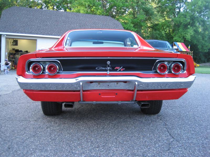

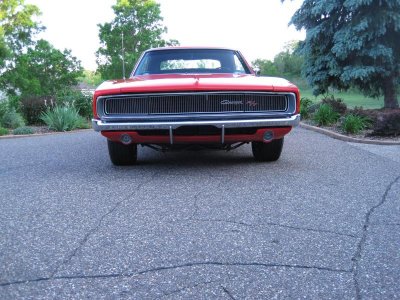

Great photos of the car and truck and very good looking young Charger drivers there! By the time the young-uns get old enough for college, im kind of betting with myself you wont be able to part with it.. Its one beautiful Charger and i may of said it before, but 68 is, TO ME, the best looking model of the Chargers.... With me, its just those tail lights, hard to get away from the style... Have fun and enjoy, You sure earned it!

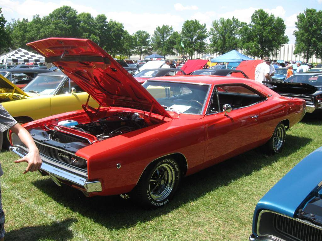

Made it to the show
Hello all. I am a week late in the update at the Mopars in the Park show in the Minneapolis area. It has turned out to be the third largest Mopar gathering in the country and based on the number of people and cars might be gaining speed for second. The weekend turned out perfect weatherwise and it was the cars first real run out. I met up with my local buddies who have a herd of well known Mopars in the area so we all met early last Saturday morning to convoy out. Very nervous and excited to drive the car more than around the back steets and neighborhood I didn't know what to expect. We had been fiddling with numerous items up until the day so I felt pretty good I would make it. We left the house and I followed my buddy in his 68 Hemi Charger RT towards the highway. As soon as he hit the on ramp it was "SEE YA". I had a huge pit in my stomach so I let her go too and mashed the gas and it was off to the show. It drove beautiful. Smooth, straight and on the money. I know each and everyone reading this knows the feeling and stupid smile we have on our faces the first time you hit the throttle on your machine and it just wants to go. I had a BIG STUPID SMILE:happy7: No problems except for the damn fan shround that I can't seem to get from hitting the fan and making a horrible noise. We enjoyed both days of the show and at the end I wasn't paying attention until they called my name right after the winner and won what I believe was second place for 68-69 B Body Class. My friend thought it was third, but I don't know. Anything after first doesn't say on the plaque. All is well in that I was very happy with all the attention and complements I received and made me feel good. It makes the headaches and frustration seem more distant. I still have quite a bit to do in the detailing and fiddling work so maybe I will get it next year. I am just excited to be able to get in it and go for a ride while I work the gremlins out. Now what the hell am I going to do now that it is almost done? Thanks again for everyones support and once again I hope I may have been a help or inspiration to anyone on the same journey. I will keep you posted as the final detailing comes together. The wife took the camera with her out of town so all I got were crap phone photos.
Congrats on the prize at the show. Well done for a superb resto, it's reading stories and journey's like this that keep us all pumped for our own projects. Great work. :VB toast:
Your car looks great. Congrats on placing in the show. Your car was definitely one of the best there.

Thanks for the shot
Thanks for the great show photo. Shoot the bull you say? I'm not as pretty:grin:LOL. Now you all know my last name so no Richard Nixon jokes please. I have the "I am not a crook" bit down pat.
Great show number 426. Too bad it isn't that to go with it.
