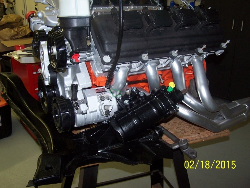

Here is a picture of my 6.1 with the 2.5 headers and borgeson steering box. I went with the Borgeson box because of the smaller size and half the weight. Plus it can take the higher pressure from the later model pump. The green circled area show how tight the area is with the 2.5 headers. Maybe the 3" header has a different bend in the front tube. It could have been made to fit better IMO but I am happy with the outcome on mine. If I were not running A/C mine would have fit perfectly.
That's almost a close as the hair is to your head or as close as the white is to your eyes now that's close! Great information and pics. Looks really good. Looked at borgeson website today and will plan to go that direction and go with 2.5" headers 61rsa-c4 from tti. Can I ask are you cooling the power steering fluid and have you had any issues with blowing seals? Thanks for all the help!
Another question. Will the factory headers work with the borgeson application? Just curious we haven't
got that far yet I suppose it would be really tight?
I am not cooling the PS fluid. Have not had any problems with it at all. There are no issues with blowing the seals with the Borgeson unit. That problem is associated with using the old factory steering box. The vintage pumps did not have the higher pressure that the newer pumps provide.

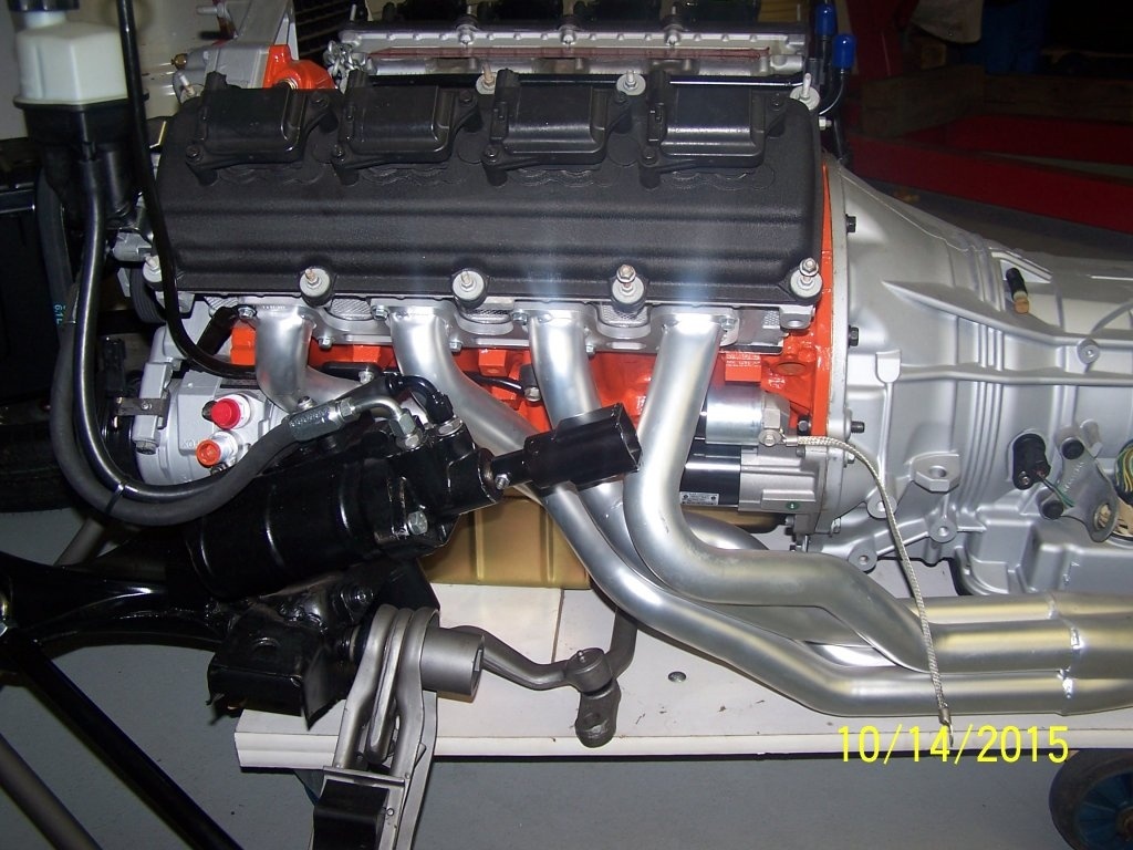

Here is a pic of the plumbing on my Borgeson. I bought the pump, fittings and hose from Bouchillon. I like it because it is a better steering ratio like the new cars have. I think it is 3.5 turns lock to lock.
As far as the factory headers, I was told they would need surgery to turn them down because they are too close to the firewall. I do know that Dream Catcher on this site used the factory headers on his 5.7 install but he moved the engine and transmission forward a couple inches.
